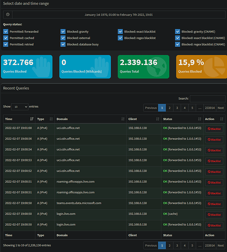

Since few weeks I think something is wrong resolving the queries because when I'm using web browser (Chrome, Firefox, Opera) in my personals computers/laptos or smartphones I get 75% the time "dns probe started" or "DNS_PROBE_FINISHED_BAD_CONFIG" and the webpage never load, if you refresh it few times it load, sometimes you can't even watch any youtube video or play any games because you don't have internet connection at all. Since few weeks it has gotten worse and worse until today in my computer and smarthphone could not connect to Internet.

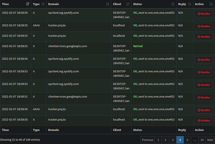

I know something is wrong with pihole and not my ISP, because I just turn off pihole and use ISP DNS and everything works fine as espected. Sometimes I saw in queries logs "Reply N/A" or "Reply 170ms"
That's why I think something is wrong resolving the queries. As I said ~75% times pihole fails and sometimes it works perfectly fine. I rebooted my sistem and pihole services few times, my sistem is up to day "0 packs need to be upgraded"

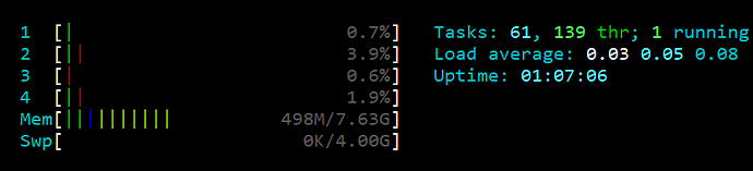

i see in pihole -t real time queries being forward ok, but I see a lot of traffic, maybe my sistem could not handle that? My cpu is working at 5% all the time, 7gb free of ram and i did not have a issue like this before in +6 months with same volumen of traffic.

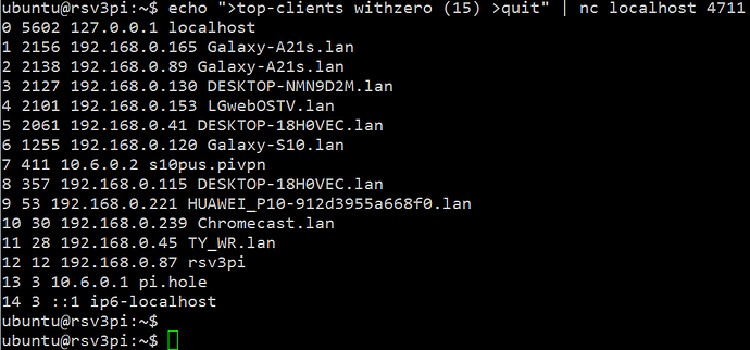

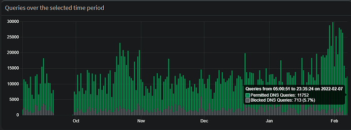

Let's take a look at the query volume. Please post the outputs of the following commands from the Pi terminal - you can paste the output into a reply.
echo ">top-clients withzero (15) >quit" | nc localhost 4711
echo ">top-domains >quit" | nc localhost 4711
echo ">top-ads >quit" | nc localhost 4711

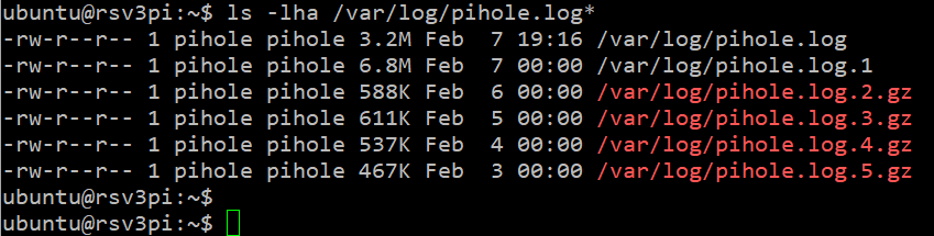

ls -lha /var/log/pihole.log*
ls -lha /etc/pihole/pihole-FTL.db

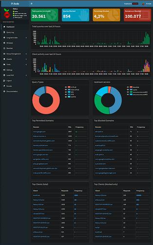

There is nothing out of the ordinary in these outputs. This is a relatviely low query volume and nothing that should impact the performance of the Pi.

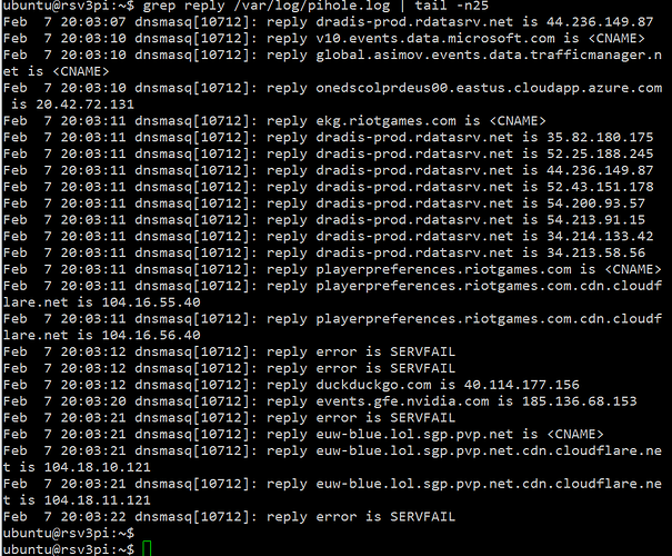

Let's take a look at some of the replies in the dnsmasq log:
grep reply /var/log/pihole.log | tail -n25
The SERVFAIL messages indicate your upstream DNS server did not resolve the query that was sent to it.

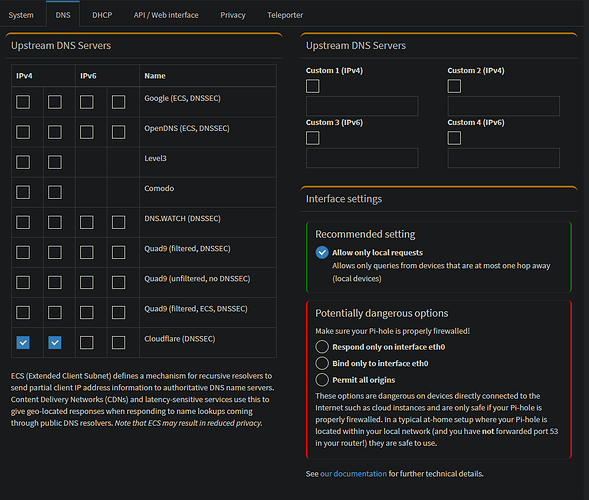

My upstream DNS is 1.1.1.1 and 1.0.0.1.
Should I add more upstream DNS servers here?
I would start by changing the upstream servers to one of the other choices. See if this clears the errors.
I already tried it. I swapped it to OpenDNS ipv4/ipv6 for few days ago and the results where the same, I even used 4 DNS OpenDNS and Cloudflare ipv/ipv6 and the problem still.
Yep, still same error. I swapped it again
I still having the same issue, there's something else that I can do to fix it?
