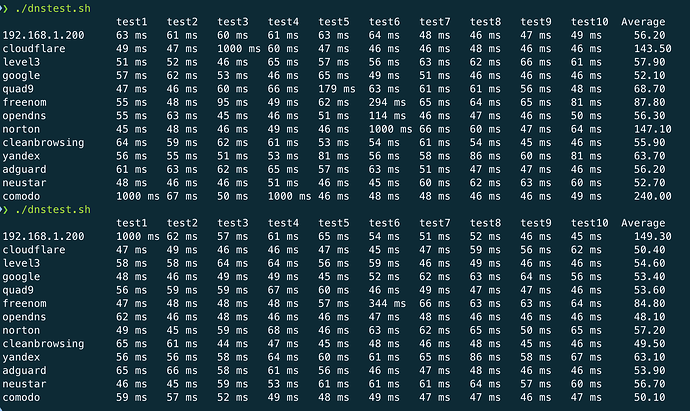

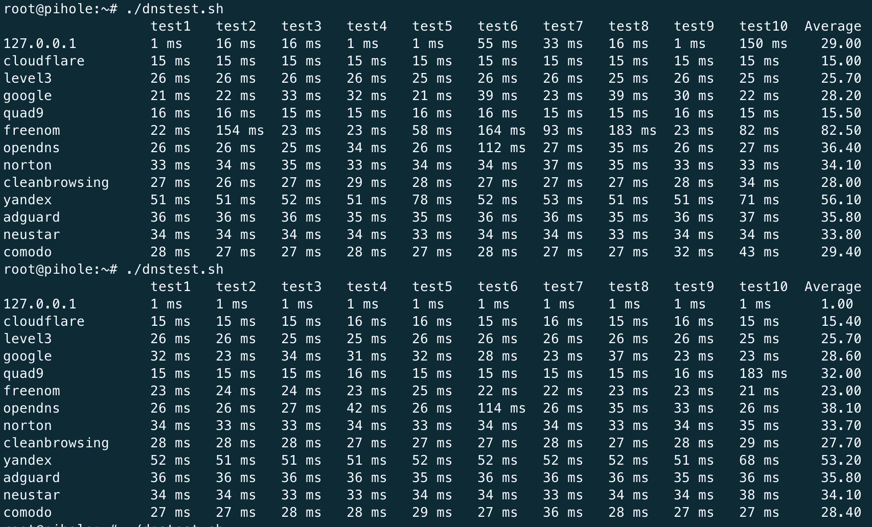

I am running Pi-Hole + Unbound and I noticed that running DNS Test on the Pi-Hole, I get good performance:

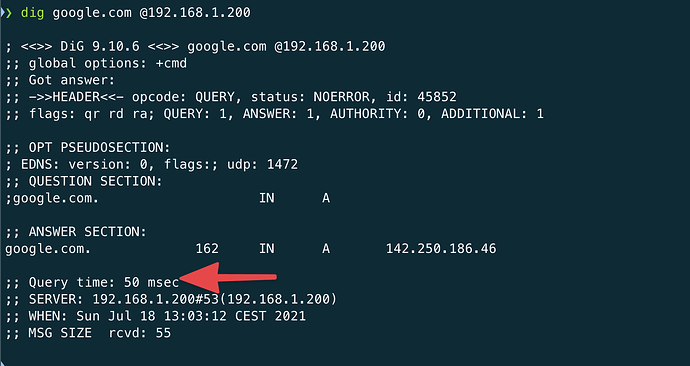

Running it on my MacBook, I get almost same performance as via "outside" DNS (my Pi-Hole is 192.168.1.200):
Running a "dig www.google.com" results in a query-time of 50ms on my MacBook:

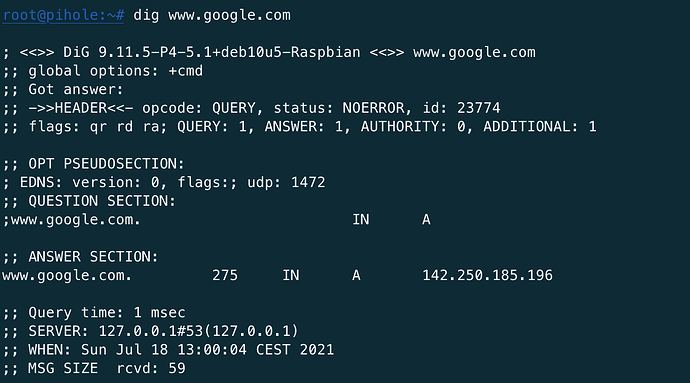

Running the same on the Pi-Hole is expected fast:

  1. Querying the Pi-hole on the Pi-hole itself (127.0.0.1) for a cached entry is fast as expected: 1ms
  2. Querying the Pi-hole from another device in the same local network (192.168.2.100) but for the same cached entry is very slow: 50 ms
So the question is why his internal network is so slow as the Pi-hole doesn't seem to be the issue here.

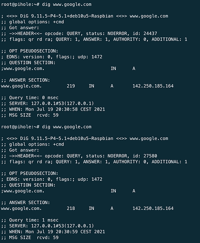

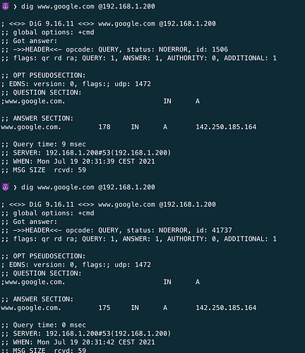

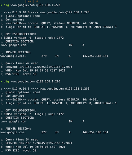

This is correct - I repeated it a few times:
Mac:
vs PiHole:
vs Hassio (IOT device on another VLAN):

If I can deliver any other diagnostics, let me know. To me it does feel the issue is with the Mac. I just want to rule out any issue on the PiHole. Networking should be fine - Unifi gear all round with 1Gbs LAN connectivity.
Your dig results would be in line with a longer response time for a first query, followed by shorter ones that Pi-hole could answer straight from its cache.
Pi-hole's Query Log should reveal which replies have been served from its cache.
If that's the case, I'd still say your observations are normal.
