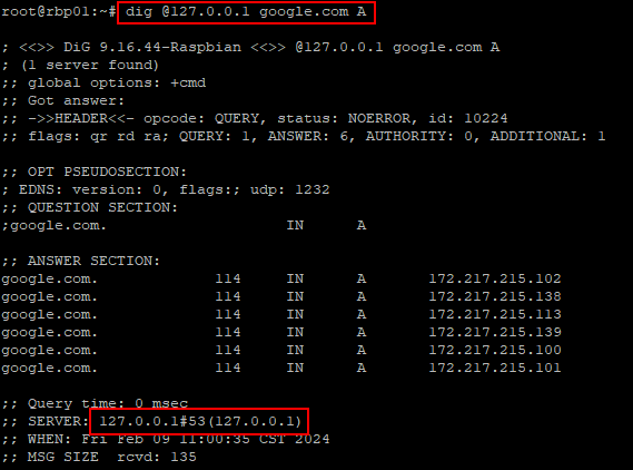

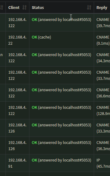

One of the things I noticed is my server in the dig command is localhost and port 53, not 5053 for either v4 or v6.
I have 127.0.0.1#5053 as my v4 upstream DNS server so I'm not sure where it's getting 53 from.
I've verified both config files and 5053 is defined in both files. Here is the output of the command.

Nah go in the PI and do "ip6tables-save" and show me the output please
I am running this on a RBP3b using DietPi. When I run ip6tables, I get "command not found." The only things I have installed on here outside of the default DietPi setup is PiHole, Cloudflared (v4) and now Cloudflared (v6). I've not set up a firewall to run on DietPi. I am not using my PiHole for DHCP only DNS if that makes a difference.
Did you see my other message about the localhost resolving over port 53 on both ipv4 and ipv6 in the dig command?
Been thinking about this on and off and I'm not sure what's up.
I have an Asus router so I replaced my pihole with Asuswrt-Merlin and Diversion so I can't do much testing...
Please post back if you figure it out, or hopefully someone else is more helpful than I. Good luck!
What os are you running on your pi? Did you setup a firewall or are you using the default install of the OS?
Dumb question but do you have the cloudflared service actually running? I've disabled or stopped it before and never realized it...
I double-checked the services and they are running.
I tried the dig commands again and all resolutions came back using port 53 (ipv4 and 6) even though both of my upstream DNS servers specifically use port 5053. I added an attachment of my DNS settings. My query log shows port 5053 being used to answer requests, at least for ipv4, I don't see any ipv6 addresses trying to be resolved in my query list at the moment so I cant tell if that's working as expected or not.

You're adding the @ sign before 127.0.0.1 as @127.0.0.1 for the dig command? without @ I get port 53. With @ I get 5053.
Yes I am, I just cant use that symbol in my post since my account is newer, it thinks I'm trying to tag someone.
Here is a screenshot of the first dig command showing the symbol.
You can use @ even with a new account using 2 different techniques:
  1. Post inline code using code blocks:
    On the editor window, type your line of code inside backticks (`) to create a block, like this:
    `text with @`, will be shown as: text with @.
    You can achieve the same result selecting the text and clicking on the code block button: </>
    (or pressing CTRL+E).
  2. You can "escape" the symbol, adding a single backslash (\) before the symbol:
    \@ will be shown as @.
