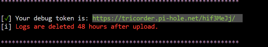

Debug log:
https://tricorder.pi-hole.net/hif3MeJj/
However, when opening the debug link, it only shows a blank page. Is this expected behavior, or does it indicate that the debug upload failed?
Thank you very much in advance for your support and any insights you can provide.
This is expected.
Only Pi-hole team members are allowed to access uploaded files.
If you want to see your own log, it was saved on your machine: /var/log/pihole/pihole_debug.log.

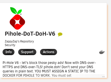

I am using the Pi-hole-DoT-DoH-V6 Docker image from ZappyZap’s Repository on Unraid.
This is not developed by Pi-hole team.
Please try to ask for help on ZappyZap’s Repository.
I switched from the Pi-hole DoT-DoH-V6 image to the Pi-hole DoT-DoH image from the same developer. So far it’s been running well for about 24 hours. Let’s see how it looks tomorrow.

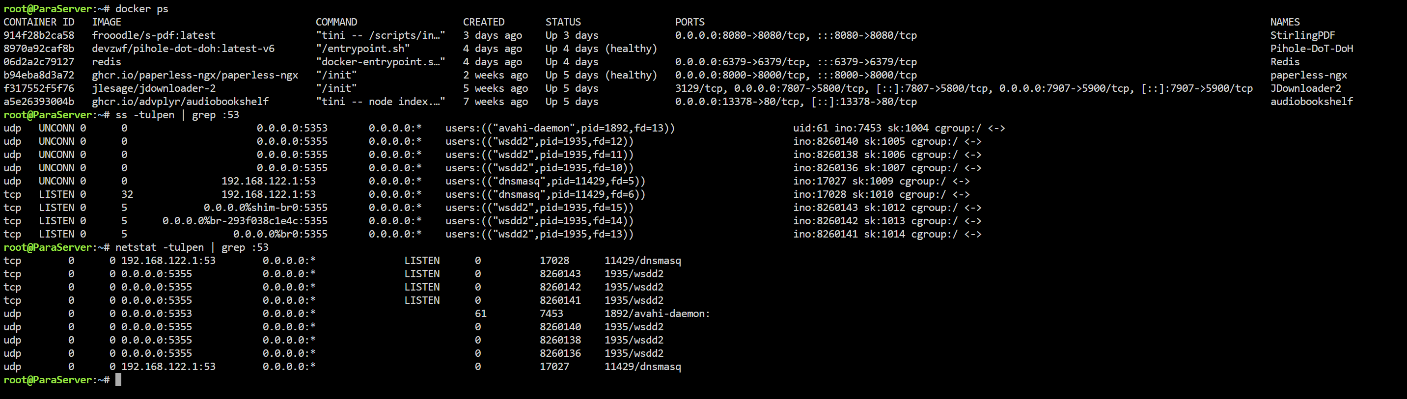

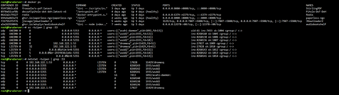

Pi-hole DNS timeouts after 3 days – wrong interface binding (resolved after reinstall)
I was experiencing intermittent DNS timeouts when querying my Pi-hole at 192.168.178.2.
At one point, ss -tulpen | grep :53 showed that pihole-FTL (dnsmasq) was not listening on the LAN IP. Instead, it was bound to a different internal interface (192.168.122.1), which is not part of my LAN (192.168.178.0/24).
Because of that, DNS queries to:
192.168.178.2:53
resulted in:
DNS request timed out
no servers could be reached
So the container was running, but nothing was listening on the correct LAN interface.

It hasn't:
paraserver-dnsmasq
Pihole's process would identify as pihole-FTL, so your screenshot shows that it was indeed dnsmasq binding that port, i.e. there really was a dnsmasq instance running on your machine. And when that is up, it may prevent other processes from binding port 53 (including pihole-FTL).
Since you are running your Pi-hole as a Docker container, I'd anyway expect docker to show up rather than pihole-FTL, unless you'd be running your container in host mode.
