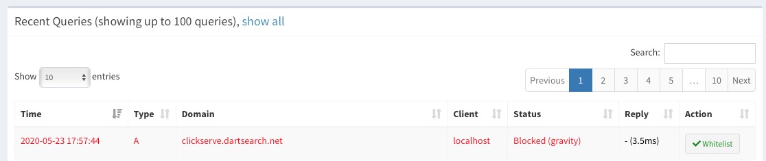

I see the problem is just a confusing UI:
### Recent Queries (showing up to 100 queries), [show all]
Search:
Show  10 entries
One naturally expects that when you enter a search that means it will stop the search after the most recent 100 matches, and then show the first ten on the current page. But instead it means it will only search the most recent 100 matches. Which pretty much means unless I hit the search in less than 30 seconds after the query, the search will never return a hit.
Instead it seems you have to press "show all". Then after a significant delay the log file is scanned, at that point the search will act as a filter, not a search of all the entries currently listed.

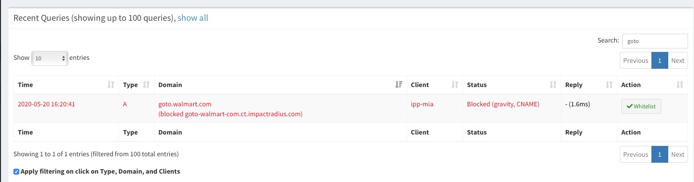

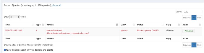

Click "show all" at the top, then select "all" in the pull down menu. Then search for clickserver.dartsearch.net and post a screen snap of what shows up:

The original problem statement was that DNS lookups were blocked but not logged. Is that still the case? Or is the problem that the query log does not behave as you expected and it took more steps to see the blocked query?
