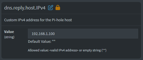

Try setting FTLconf_dns_reply_host_IPv4: '192.168.1.100' in your compose file.
I gave it a try and that does not seem to have worked. The setting was read properly because the web interface setting is now showing this:
But even after flushing the DNS cache on my device, nslookup is still reporting 172.19.0.2 as the IP of the web interface.
The IP is also unchanged in the system settings web portal page.
Please try:
      FTLCONF_dns_reply_host_IPv4: '192.168.1.100'
      FTLCONF_dns_reply_host_force4: true
That combination did the trick!

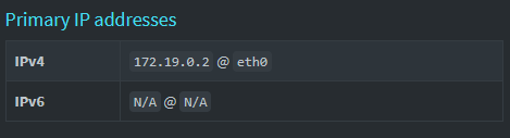

It might be worth adding those settings to the default compose file since I assume more people will run into this issue with the docker install. Also, the primary IP address listed on the System Settings page is still the container's IP (172.19.0.2 in my case). That's not a problem for me but I'm not sure if it's the intended behavior so I thought I'd mention it. Thanks for your help!
