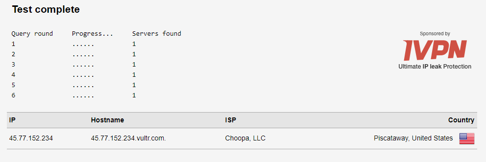

_[The extended test from https://www.dnsleaktest.com is showing my DNS queries are being sent to:
I don't know who these people are or why my system would be sending DNS queries to that IP. I tried in Chrome, which is using my system DNS. I have my system set to use the pihole only for DNS, and the upstream servers are set to CloudFlare.

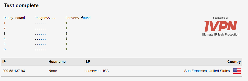

I also ran the test in Firefox, which I have set the DNS over HTTPS setting to use https://dns.adguard.com/dns-query (just for testing). I would expect running the test from the Firefox browser would show 176.103.130.131 or 176.103.130.130, the IPs for dns.adguard.com. But I get the same result in both browsers.

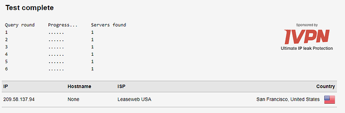

Maybe I'm misunderstanding how the dnsleaktest website actually works, but if I connect to a VPN I purchased and run the DNS leak test, the dns server IPs show up as the VPN Providers addresses:

That IP (the vultr.com one) is the host you are running Pi-hole on (cloud server or maybe your service provider?).
Does it match with the output whatsmyip.org ?
So the host Pi-Hole is on is a Ubuntu laptop behind my Comcast router and the public ip is 24.x.x.x so it's not from them.
Ok. Then, you should see your Cloudfare IP as your DNS on the DNS leak test.

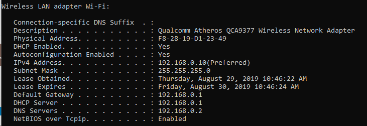

The ip of the pihole is the only ip in the dns settings for the machine in question.

@Jorgsmash, you are just seeing the actual IP of the box you are connecting to for your DNS. If everyone is configured for 1.1.1.1 we are not all hitting the same server somewhere. Cloudflare has a whole network (including vultr.com) that services the world. In the test above that is the specific IP you hit within that cloud of computers serving whatever your DNS destination is.
Pretty much this
For what it's worth, when I run that test from my network, it finds either 5 or 6 servers in each of the 6 query rounds, but they all show "Cloudflare" as the ISP.
@capboomer Thanks for the clarification. I do however wonder why, as @jec0047 mentioned, it doesn't show cloudflare as it once did. I have ran this test multiple times in the past to find that the results show Cloudflare. I was concerned because when I looked into the vultr.com company they came back with very poor reviews and I didn't know or trust these people.
