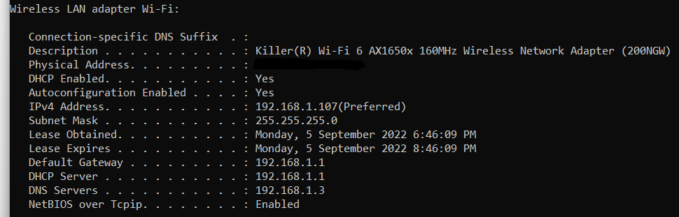

On your Win11 laptop, what's the output of
ipconfig /all
We'd only be interested in the DNS server section.

here's my ipconfig /all screenshot

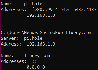

If none of your Win11 browsers is using DoH, let's check whether DNS requests would make it to Pi-hole.
Run from your offending Win11 client, what's the output of the following commands:
nslookup pi.hole
nslookup flurry.com
When executing those requests, closely watch Tools | Tail pihole.log:
Do both of these requests shop up?

here's the output from the command.

As explained, a browser with DoH enabled will by-pass Pi-hole.
If you want to evade your ISP's DNS resolver enforcement via DoH, you could consider to setup a DoH proxy like cloudflared on your Pi-hole host machine and use that as Pi-hole's only upstream DNS server.
