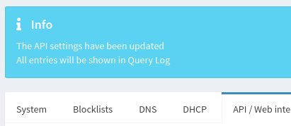

Hi yubiuser, I've tried to add the domain following your instructions but, when I save, domain disapperars from the list and I still see the domain in Top Permitted". It seems not saving the configuration...
That clearly should not happen. Was there any error indication?
On success the message should look like this.
Try to clear your browser's cache and try again.
