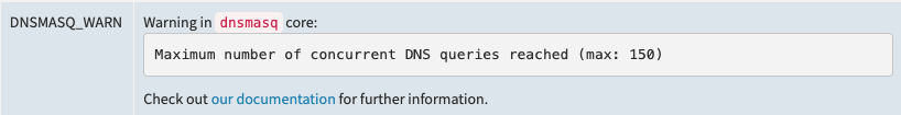

Hello!
I get this error. Which is normal because i have many VM using same Pihole.
But I have PiHole in a docker container. And I have other parameters like FTLCONF_RATE_LIMIT: 0/0
But I can't find the parameter to disable this warn, I have searched for Configuration - Pi-hole documentation and nothing in all the documentation does not mention it.
Thank you very much for the help!
The configured maximum number of concurrent DNS queries for a given server is reached. The system is either very busy at the moment or not receiving queries from the configured upstream. Check your connectivity or the upstream DNS server status.
The warning can also be printed when being spammed with an excessive amount of duplicates or when the upstream server never replies for specific domains. Check your logs and try to identify similarities between the query directly preceding this warning and earlier queries in /var/log/pihole.log . Try to find out if your upstream does maybe never reply to specific domains and fix this.
This warning is printed at most once every five seconds (per upstream server) to help mitigate unlimited log file growth.
Yes, that the warn.
But not how to fix it.
I want to increase that limit of max 150

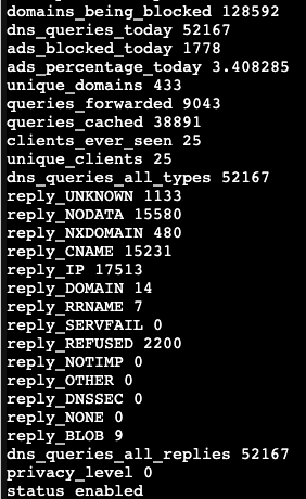

Run from inside your Pi-hole container, what's the ouput of the following command:
Usually, 25 unique_clients is far too low a client count to trigger that warning.
This would suggest that the warning would be related to a DNS loop of sorts or to a specific client desperate for resolving a blocked domain.
As recommended by the docs, you should scrutinise your logs for specific clients and domains around the time of the warning.
