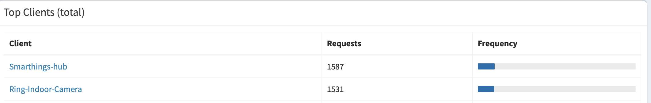

You don't have to use condition forwarding to fix this.
You can map the local clients to IPs in a hosts file on the Pi, and Pi-hole will then know the names.
Snippet of /etc/hosts on one of my Pi-holes:
192.168.0.97	Sonos-ARC
192.168.0.100	Pi-3B-plus
192.168.0.101	Scanner-Brother
192.168.0.103	Smarthings-hub
192.168.0.104	Sense-electrical-monitor
Any requests to this Pi-hole will map the name to IP or vice versa.
nslookup 192.168.0.97
97.0.168.192.in-addr.arpa	name = Sonos-ARC.
nslookup Sonos-ARC
Server:		127.0.0.1
Address:	127.0.0.1#53
Address: 192.168.0.97
This also allows Pi-hole to show clients by name instead of by IP on the web admin GUI:
