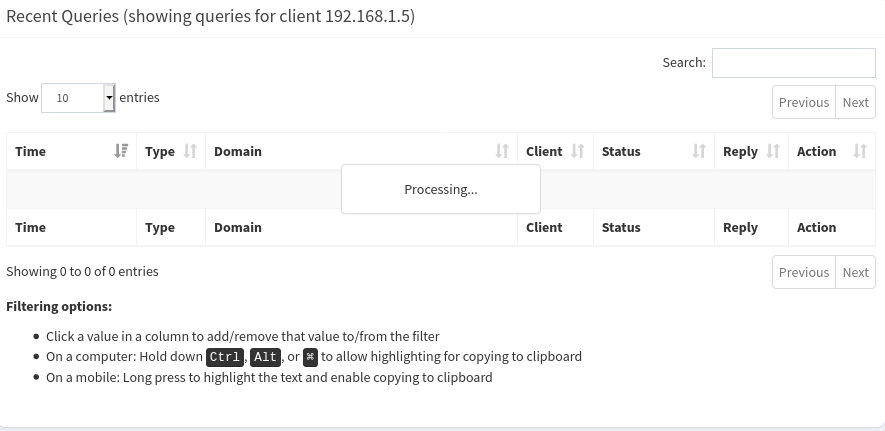

Display a list of thousand of requests is very slow
From the dashboard i select an IP to see it's request (75000) .
I see 'processing' and many times wont display anything and
some times it will after apprx 30-60 secs.
Is there a way to make that faster? Like deleting old requests?

Are you in the query log, or in the long term data section?
A screen shot would be helpful. In this forum you can paste one directly into a reply.

As those 75,000 requests are from recent queries (as detailed by your screenshot), they are already held in memory, so only more powerful h/w could improve responsiveness, as both yubiuser and jfb have already pointed out.

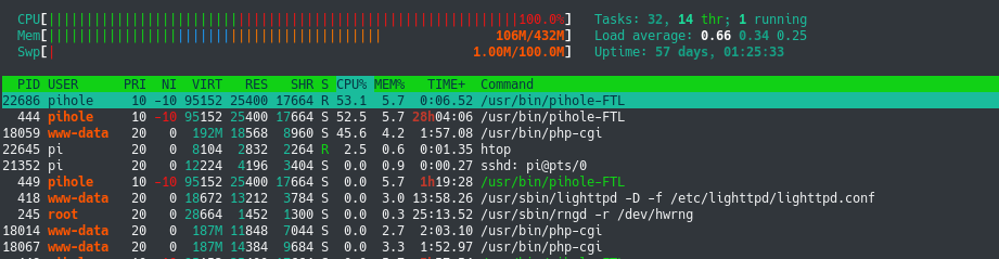

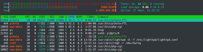

That is htop output from my pizero (Raspbian GNU/Linux 10) while i commanded pihole to display 80000 requests.

This is not unusual. A Pi Zero is a very low powered device, and pushing a lot of traffic through pihole-FTL and PHP is going to tax that device severely. I suspect that you would not see a similar problem on higher end hardware like a Pi 4, for example.
From your htop output, some additional info would be helpful to determine exactly which processes are at work.

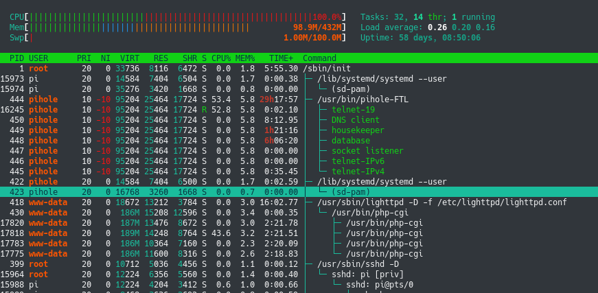

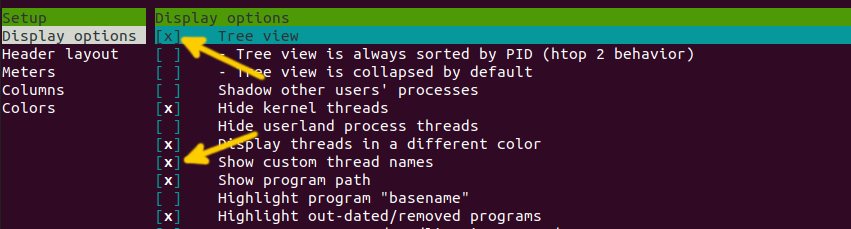

Reveal the tree view + custom thread names option and see what this shows.
https://discourse.pi-hole.net/uploads/default/original/3X/a/1/a1ec07745a66a594a4c085ecabb928f2101a71b1.png
Well for displaying 40000 queries the display was relative ok , 10-15 sec.
