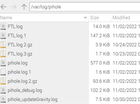

I don't think there is a failure with log rotation.
While it intends to prevent log files from growing out of proportion, it does so by checking, moving and removing log files on a regular basis. Specifically, it does not monitor remaining space continuosly.
So if you haven't explicitly reconfigured it, most Linux distros will run logrotate as a daily cron job.
In your case, available storage space likely is exhausted before logrotate is even starting its daily processing.
Your individual log growth rate would depend on the number of clients and their level of DNS activity.
That means I can't give you a final verdict, but while 1 MB per hour still seems a bit on the high end, it could be reasonable for your network.

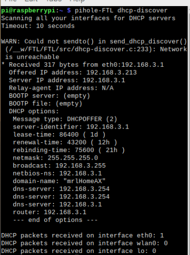

Your debug log shows you've enabled Pi-hole's Conditional Forwarding, but your local domain mrlHomeAX differs from the one distributed by your router's DHCP server mrlHomeAX.local:
   * Received 323 bytes from eth0:192.168.3.1
     Offered IP address: 192.168.3.197
     DHCP options:
      Message type: DHCPOFFER (2)
      domain-name: "mrlHomeAX.local"
      dns-server: 192.168.3.1
      dns-server: 192.168.3.254
      router: 192.168.3.1
      --- end of options ---
Adjust any of those local domain names to make them match.
In your case, it would be preferred if you changed the name your router is using, as .local is reserved for mDNS usage and shouldn't be used with DNS.
In addition, your router is distributing its own IP as local DNS server (twice), and together with Pi-hole's CF, this would be a precondition to potentially close a DNS loop (depending on your router's upstream DNS server configuration), and/or would allow clients to completely by-pass Pi-hole via your router.
Pi-hole must be the sole DNS server for your clients, so configure your router to just distribute Pi-hole as local DNS server.
Then verify that your router is not using Pi-hole as upstream DNS server, if you'd want to avoid a partial DNS loop.

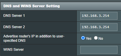

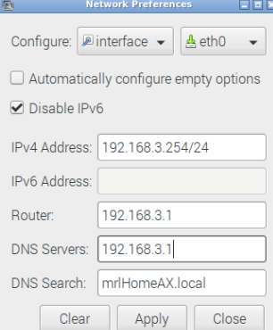

Sorry for all the screen slips--I'm a visual type.
This is my raspberry pi ethernet eth config with pi-hole being 192.168.3.254. I'm also using unbound.
My main router is 3.1 (I changed the router domain name to mrlHomeAX per your comments).
  • What should the DNS server and search be?
  • Is the current config the reason I am seeing 3.1 as DNS server? Should it be 192.168.3.254? What in that case would the DNS Search field be?

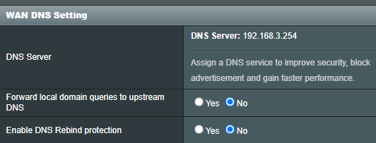

  • I set the WAN DNS to pi-hole (3.254) because it seemed like some clients (my phone) were bypassing pi-hole when I configured it to some commercial DNS (Quad-9 or Google). I also have guest wi-fi (192.168.101.x assigned by Asus) used for IOT devices, which I don't want/need to run thru pi-hole. There is no DNS field for these guest networks, so I assume it uses the WAN DNS configuration.
    My LAN DNS is directed to pi-hole. Should my WAN DNS point to pi-hole or not?
Thanks again for all your help.
Gonna offer some input here, not a dev, just a user like you. LAN DNS should be Pihole, WAN DNS might need to be a public DNS server like Google or 9.9.9.9 (Quad9), as some routers don't like having their WAN DNS pointed to Pihole (mine, a Synology 2600, most definitely is one of those!).
I think your DNS Search Field needs to have the ".local" part removed. The "home.arpa" suffix is a recognized setting for this, there are a few others that are considered acceptable as well.
