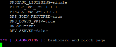

It hangs since many (~15 min.) on at this point you can see on picture.
My device is Zero Pi W with Raspbian lite and PiHole on it. Same Problem on PiHole Webpage for logging, but on this side i cant see anything like in SSH.

You should be able to abort pihole -d by pressing Ctrl+C.
Try to run it again after rebooting your Pi-hole machine.
