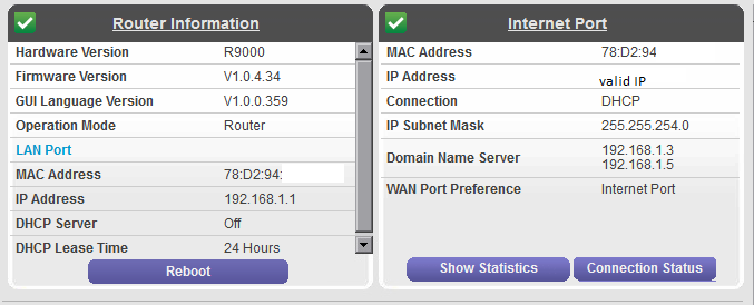

Here are the screenshots of my settings along with my router showing no assigned external ip.
https://i.imgur.com/MRJKfQN.png https://i.imgur.com/EQv3wvh.png
I'm not sure why this is happening or what I can do otherwise (aside from returning the router/modem). If you have any suggestions I'd really appreciate it. I'm also open to other solutions.

Here's how it looks on my side:
Comcast like pretty much any other ISP is authorizing the CM mac of the device.
There are 2 things that happen though. If the MAC is not authorized, the device is pushed into a "walledgarden" mode where it's seen by the Comcast network but not authorized and internet is not working.
In this case, the device DOES get a DHCP IP from Comcast.
In your case, that doesn't seem to happen as you don't seem to have an IP assigned on the internet Port which is weird.
