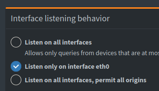

Check out your DNS settings on the Pi-hole dashboard. Is this box ticked?
If so, there you have the answer why queries from eth2 aren't replied to. This is typically a good choice, however, in your particular case not. Chose one of the other two settings and it should work.
