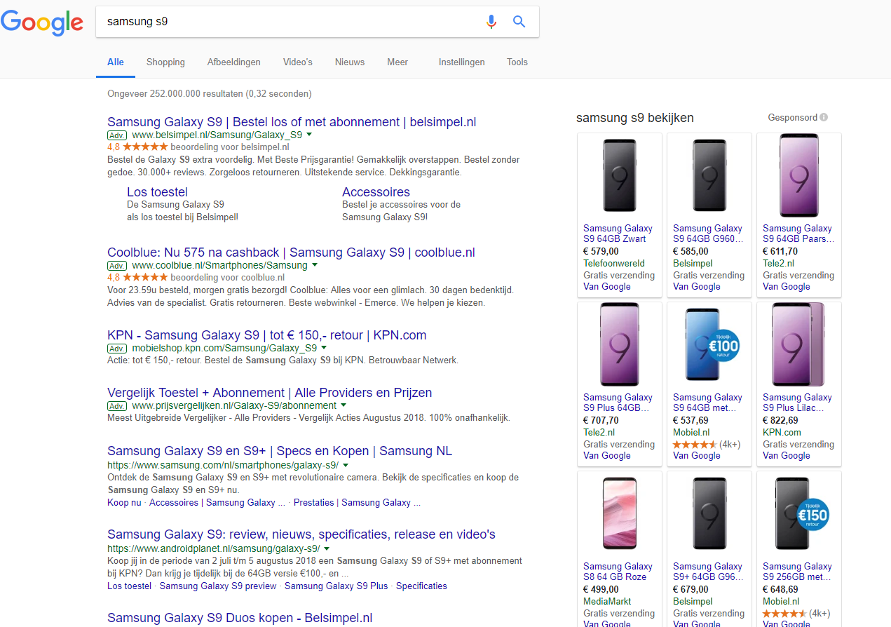

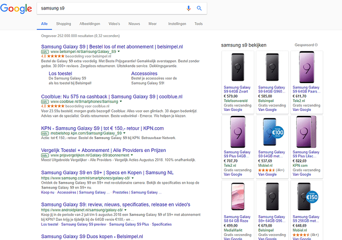

Why am I seeing adds then that I normally didn't see? My example zergnet.com is blocked but when I do a google search I see all adds
This FAQ has some additional information. An ad-serving domain might not be blocked.
Strange this is that before the update I didn't see any adds in google and now I do.
When I click on the add the site is blocked
Are you referring to the sponsored ads that appear at the top of a Google search? Prior to V4 you weren't seeing sponsored ads appear in a Google search and now you are seeing them?
yes and links with the adv block in front of them
I see this blocked also but i do see the adds

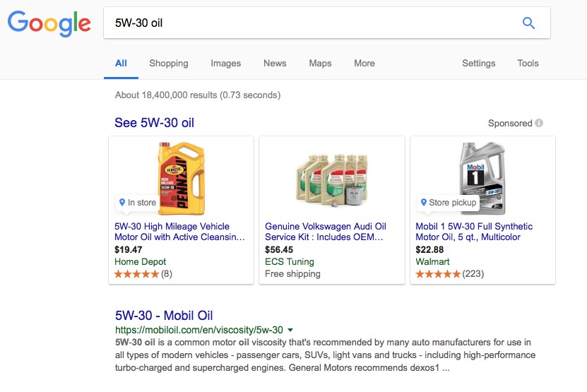

Ok. But how about those Google sponsored links and links with adv in front of them in my screenshot. Shouldn't those be blocked?
If you look at the html code for the page you loaded, I think you will find that the boxes are being served from a regular google domain, not one of the ad-server domains. It's only when you click the link that the tracking website is blocked. There may be a browser setting somewhere that controls the ads you were/are seeing.
I see the sponsored ad banner on my browsers running all the Wally3K non-crossed block lists, in versions 3.3 and 4.0 of PiHole (no change when I updated).
Ah I feel really stupid right now. I reinstalled my OS and Chrome. My add block had set the filter allow acceptable adds turned on. When I set this to off those adds are blocked. Can pihole block these type of ads?
