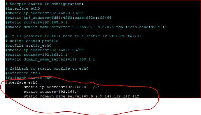

Dhcpcd.conf question about entries here
the static ip of the pihole is correct, but not cant figure out where the 9.9.9.9 and 149.112.112.112 static domain name servers came from.
i never coded that anywhere during my set up. is my pihole using these two servers? i am not thinking so.
it says my static dns servers are those external servers, but when i do a dig command
SERVER: 127.0.0.1#53(127.0.0.1) ....which is what i set up as my DNS upstream.

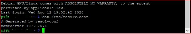

From the Pi terminal, what is the output of:
cat /etc/resolv.conf
And, what OS is running underneath Pi-hole?

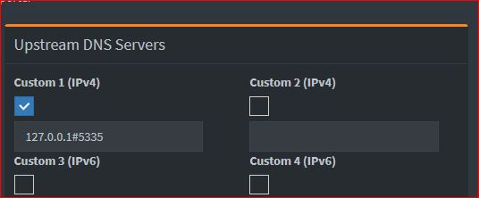

This is not quite the case. The Pi is using Pi-hole as DNS server on the loopback interface (127.0.0.1) on port 53. The Pi-hole, in turn, is using unbound as an upstream DNS server on a different port (5335) on the loopback.
Client (Pi in this case) > Pi-Hole > unbound and then back in reverse to the client.
hi jfb. the output is:
  • I'm using Raspberry OS, Debian Buster
This is why your Pi is using Pi-hole for DNS. Edit this file and change the nameserver to the server you want to use (or servers, with multiple lines).

i am not sure how the resolvconf ended up being 127.0.0.1
You can use whatever nameserver you want. Using something other than Pi-hole has some advantages - if the Pi-hole fails, the Pi can still reach the internet for repairs, updates or to upload a debug log.
You can use the same DNS server as you use for Pi-hole upstream DNS. If you are happy with that DNS for the Pi-hole, it will be OK for the Pi.

They are using two different ports on the loopback. If your Pi uses Pi-hole as DNS, then the path is as follows:
Pi > Pi-hole via loopback port 53 > unbound via loopback port 5335 or 5353 (whichever you selected) > then back again to the Pi.
A requesting client won't see the queries made to unbound - those all come from Pi-hole. Clients see the IP of Pi-hole only (either the loopback or the network IP) and always on port 53.
