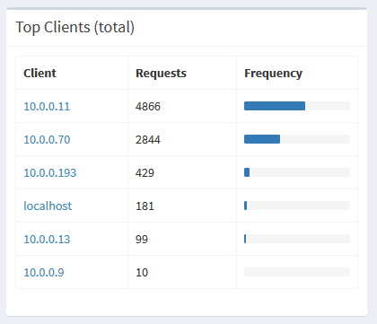

I believe if you configure other DNS servers here, it might break the displaying of the client hostnames on the web GUI.
I believe the web GUI also uses 127.0.0.1 for DNS resolution to display the client hostnames.
Maybe a mod or dev can confirm ?
