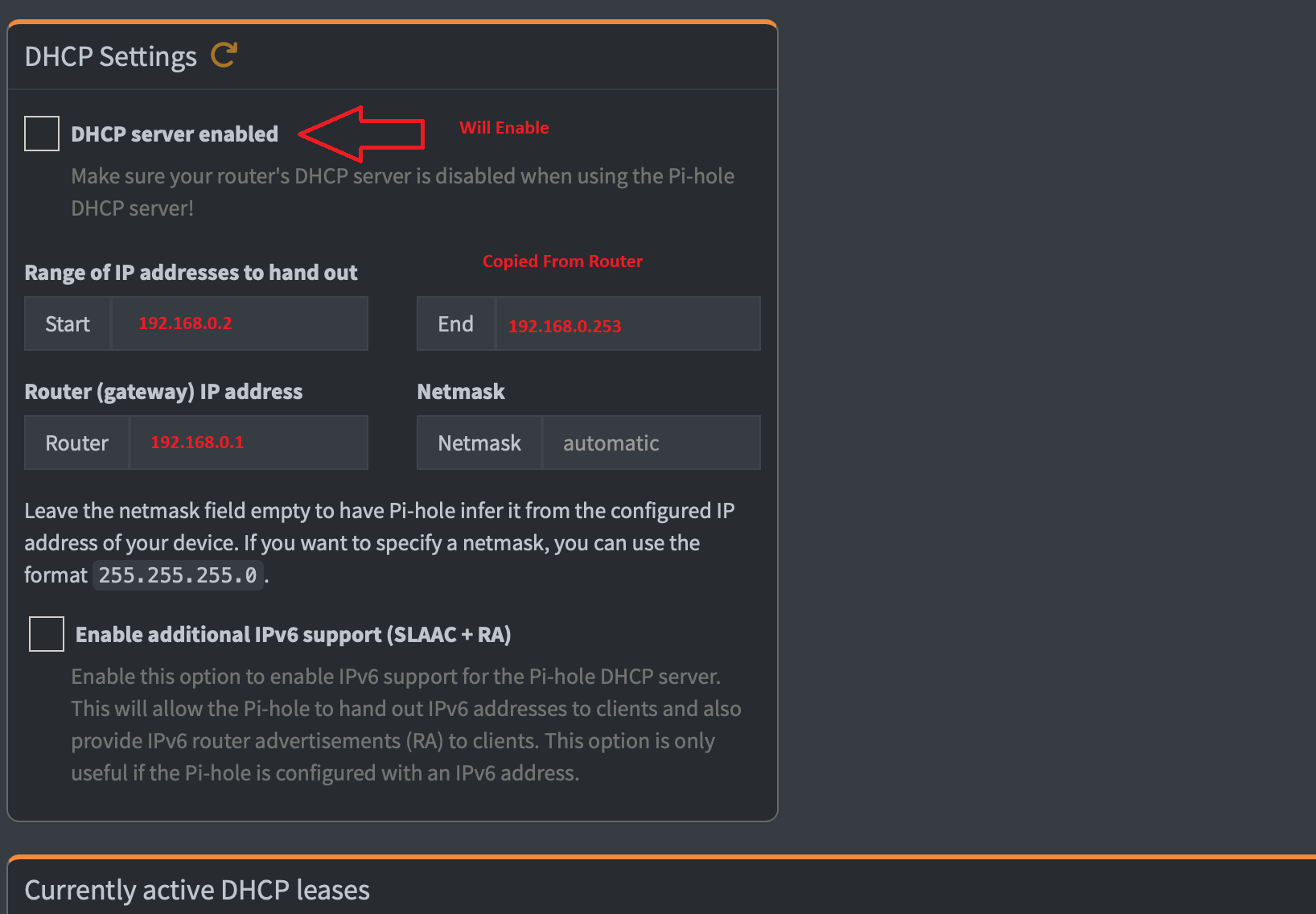

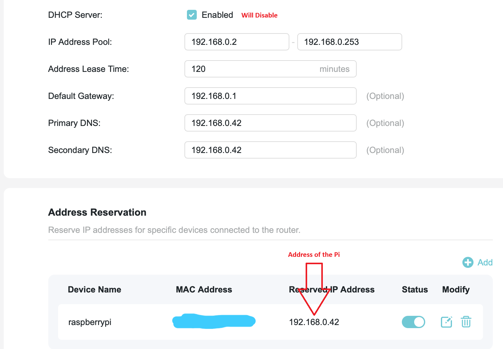

Refer to my Red changes in the images
I'm trying to use the pihole as my DHCP server
Router:
Disable DHCP server
Copy IP range and Default Gateway
Pihole:
Enable DHCP server
Copy router's IP range and Default Gateway to pihole settings
I figured this is all that needs to be done. Upon completion, my network no longer has internet or able to connect to internal resources
What am I doing wrong?
Your pi-hole is set with a static dhcp lease from your router. When you disable the dhcp server on your router, your pi-hole does not know where to get an IP from. This effectively stops the pi-hole from connecting to your network and handing out DHCP leases.
The solution is to set a static IP address on your pi-hole, that way it does not rely on an external dhcp server. I would suggest something like 192.168.0.254

Did you set a static IP on the Pi-hole machine OS, before you disable the router DHCP?
Why wouldn't I just keep, 192.168.0.42 if the pihole has already been configured as such?
Additionally I noticed you IP suggestion is one IP out of my IP range?
No I didn't
You are free to keep the pihole as the .42 IP. .254 was merely a suggestion, and it is a valid IP. Your subnet ranges from 192.168.0.1-192.168.0.254 with a broadcast address of 192.168.0.255. Your current DHCP server is set to not hand out the .254 address for whatever reason.
