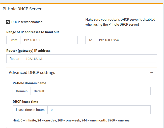

Here are my settings, My network already uses the 192.168.1.xx range.

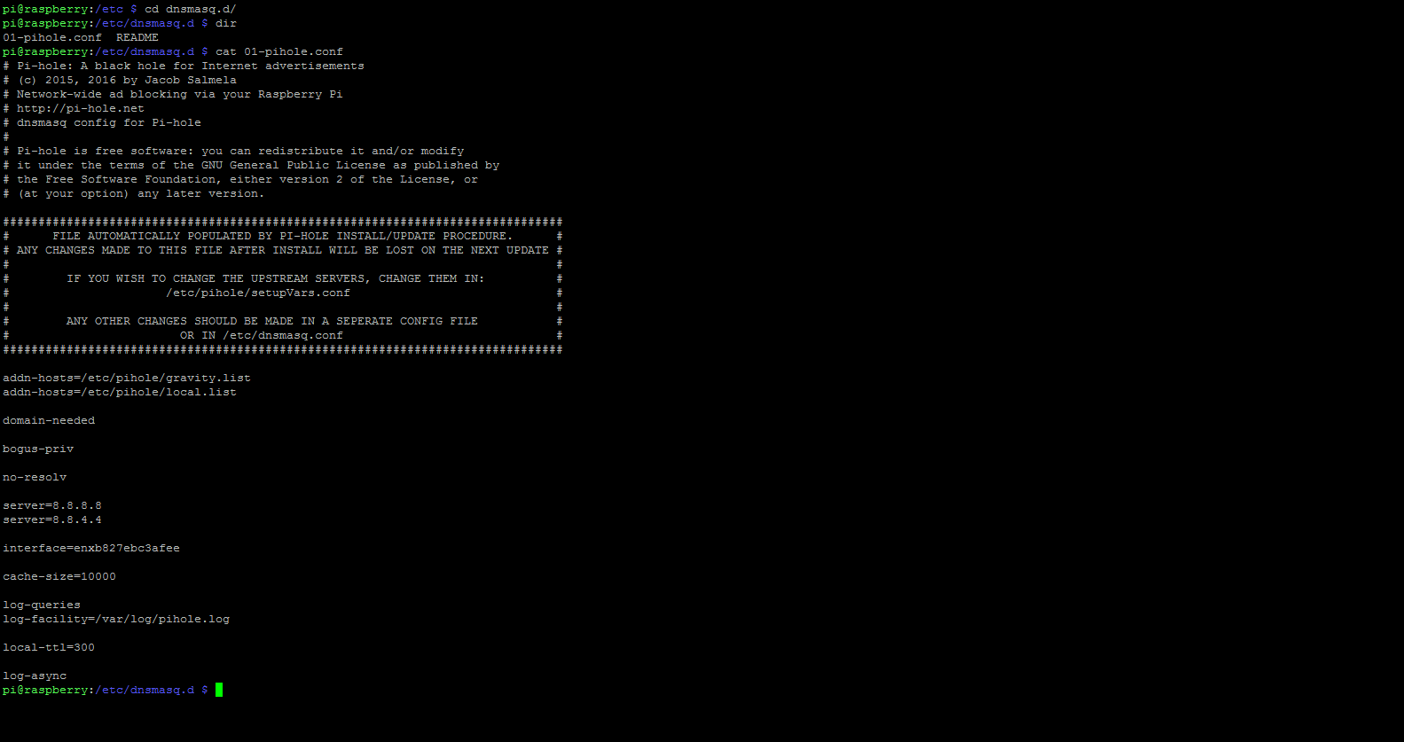

In the dnsmasq.d directory there is:
And in 01-pihole.conf there is:
Okay, there should be another file
root@ubuntu-512mb-fra1-01:/etc/.pihole# ls /etc/dnsmasq.d/
01-pihole.conf  02-pihole-dhcp.conf  README
Please check your /etc/pihole/setupVars.conf for the following settings:
DHCP_ACTIVE=true
DHCP_START=10.68.106.201
DHCP_END=10.68.106.251
DHCP_ROUTER=10.68.106.1
DHCP_LEASETIME=24
PIHOLE_DOMAIN=local
(that might of course be different for you)
If everything is fine, does clicking on "Save" (without changing any settings) on the Settings page in the DHCP dialog box fix the issue?
My /etc/pihole/setupVars.conf has all of the DHCP settings in there.
But that extra file (02-pihole-dhcp.conf) isn't in my /etc/dnsmasq.d... I also tried pressing save in the DHCP section of settings, that didn't help either.
