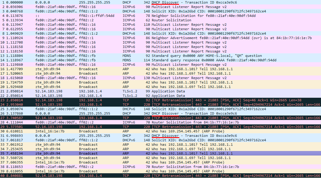

This is how it looks when using my Extender as a DHCP Server (192.168.1.250):
And this is how it looks when using PiHole (No answer to DHCP DISCOVER):
Heres my debug token: https://tricorder.pi-hole.net/uoCzlooe/

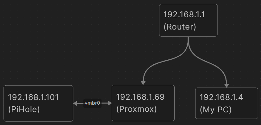

The packet sniffing was done on my PC. My Network Topology looks like this:
In my understanding the vmbr0 bridge should not be an obstacle.

So im assuming this means there is some kind of boundary between the Proxmox and the rest of the network. But i can't figure out why or where.
Im not quite familiar with (S)NAT and just read the Wikipedia article, but i dont understand how it can form a barrier for broadcast packets.

Oh the broadcast packet doesnt have a source IP address (0.0.0.0).
See the sniffing screenshots?
Its ARP based and you cant NAT ARP bc for NAT you need IP addresses in the table to translate.

You seem to have two bridges: fwbr100i0 & vmbr0.
My guess is that veth100i0 & veth101i0 are the backend interfaces for the containers.
How many containers do you run?
And can you figure out which veth... interface belongs to which guest?
You might be able to figure out by bringing the Pi-hole guest down and check if one of those interfaces (or maybe another) has disappeared?
If its the veth100i0 interface that belongs to the Pi-hole guest, this fwbr100i0 bridge that its attached to appears to be an isolated network/bridge that needs some other way to connect to your LAN.
If its the veth100i0 interface for Pi-hole, for diagnosing you could detach it from the fwbr100i0 bridge with below:
sudo brctl delif fwbr100i0 veth100i0
And attach it to the vmbr0 bridge with below:
sudo brctl addif vmbr0 veth100i0
And test if the DHCP broadcasts are coming through?

I have two containers 100 (WireGuard, veth100i0) and 101 (PiHole, veth101i0).
fwbr100i0 appears to be the Firewall for Container 100.
This shows that the forewall for Container 101 is actually disabled, since if i enable it and run brctl show a fwbr101i0 firewall bridge appears:
bridge name     bridge id               STP enabled     interfaces
fwbr100i0       8000.7266d92418fa       no              fwln100i0
                                                        veth100i0
fwbr101i0       8000.be2965b4191e       no              fwln101i0
                                                        veth101i0
vmbr0           8000.001999f7db6e       no              enp0s25
                                                        fwpr100p0
                                                        fwpr101p0

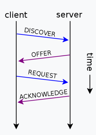

Packets 1 and 3 below are the client DISCOVER and REQUEST using broadcast (the "B" before the 0.0.0.0 source IP)
Packets 2 and 4 below are the server OFFER and ACKNOWLEDGE in unicast (IP to IP not broadcast).
pi@ph5b:~ $ sudo tcpdump -nti any udp port 67
eth0  B   IP 0.0.0.0.68 > 255.255.255.255.67: BOOTP/DHCP, Request from 00:16:3e:xx:xx:xx, length 300
eth0  Out IP 10.0.0.4.67 > 10.0.0.146.68: BOOTP/DHCP, Reply, length 312
eth0  Out IP 10.0.0.4.67 > 10.0.0.146.68: BOOTP/DHCP, Reply, length 319
