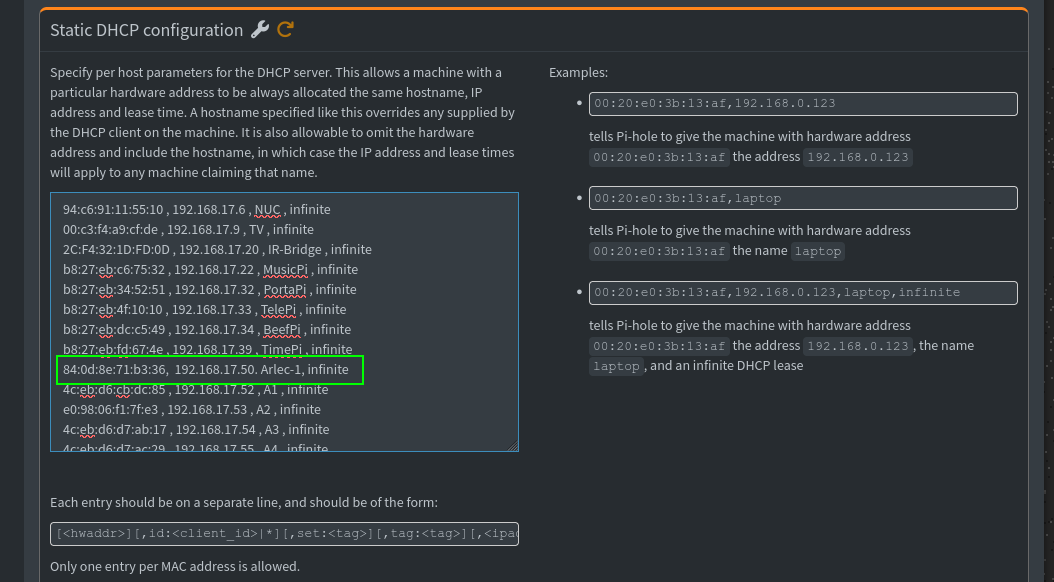

The issue I am facing:
I know it is not good but I kind of like static IP addresses.
I was looking through my DHCP list and saw this - see pictures.
Note the MAC address.

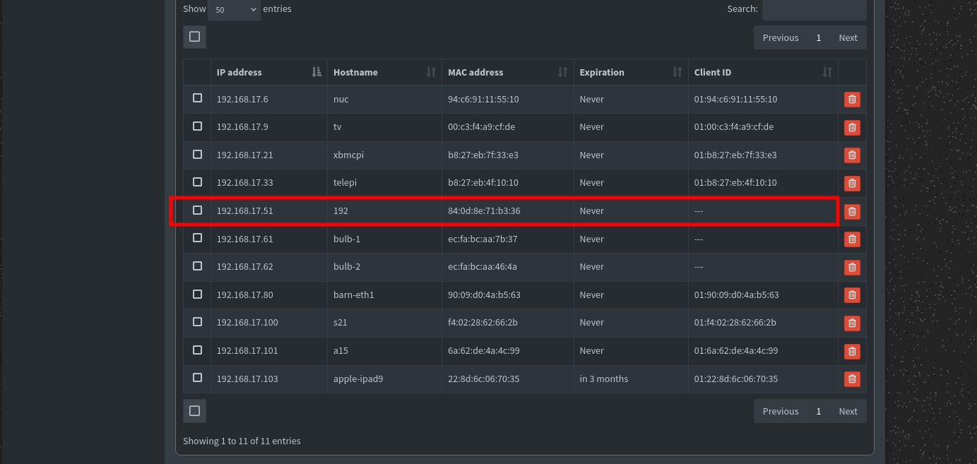

Scrolling down a bit more, I see this:
Same MAC address.
Details about my system:
https://tricorder.pi-hole.net/dJglirtY/
I am confused why if I have a STATIC lease on that MAC, it isn't working.
I believe there was a WAP outage - that device is connected via WAP - but the DHCP should have assigned it back to the fixed/static IP when it came back up.
I think I've found the problem.
There was a . rather than a , between the IP address and the name.
