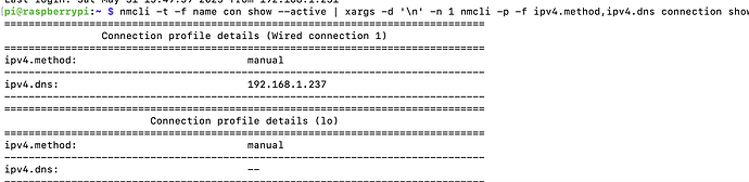

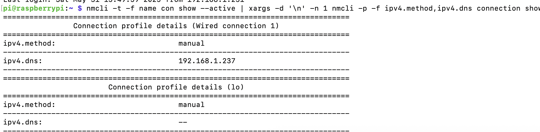

Does below one says the ipv4.method is configured "manual"?
nmcli -t -f name con show --active | xargs -d '\n' -n 1 nmcli -p -f ipv4.method,ipv4.dns connection show
It will also show other profiles that are active that might borg your setup.
Dont mind the "lo" profile!
Thats for the loopback interface named lo:
$ ip -br link show lo
lo               UNKNOWN        00:00:00:00:00:00 <LOOPBACK,UP,LOWER_UP>
yes it does.
Above ipv4.dns differs from below?
