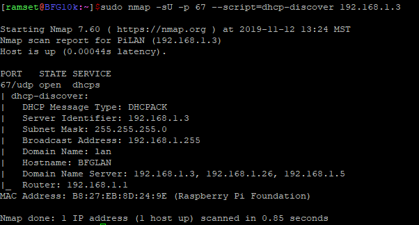

This is how it's supposed to look:
It looks (on your side) like it didn't take the script, as that's what I see if I don't use the --script=dhcp-discover parameter.
Unfortunately I cannot replicate it and I've never encountered this before.
