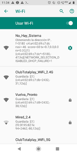

I enable verbose login on my Android wifi connections and seems to be a failure on the dhcp configuration
"Network Selection Disabled DHCP FAILURE = 1"

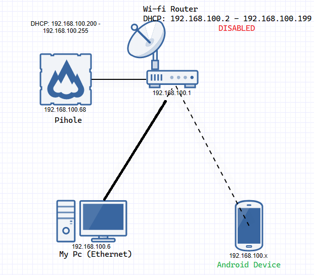

In fact, the network is as simple as this:

I can't see any Andorid request on my logs, since the Android is trying to obtain an ip without any success:

Some routers would isolate wifi clients from each other by default, allowing them only to access the Internet, while preventing communicaton to other wifi or even all locally connected devices.
Does your router have such an option?

About it not working when connected via WiFi, this sounds like @Bucking_Horn was trying to explain, somehow the AP part of your router forming a barrier for broadcast packets that are being sent from the clients with the initial DHCPDISCOVER.
Anything that gets router, NATed or Vlan's forms a boundary to the broadcast domain.
