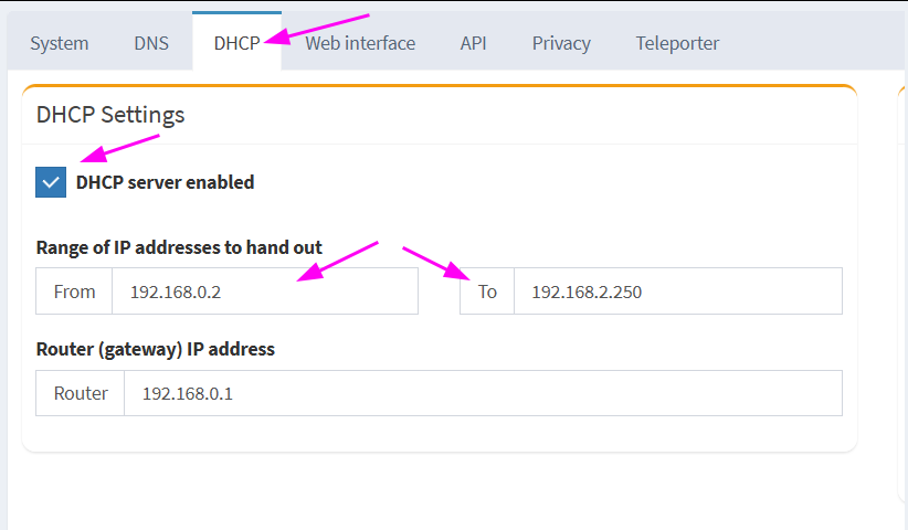

Hi community,
The server I have Pi-hole installed on has two network interfaces: 192.168.1.0/24 and 192.168.2.0/24. I'd like it to work as DHCP server for both networks, providing the addresses from respective ranges. I know how to do that in DNSMASQ, but haven't found any obvious option in Pi-hole GUI. Can anyone please send me to the right direction?
In Settings page, DHCP tab:
But you can only set for one Interface.
