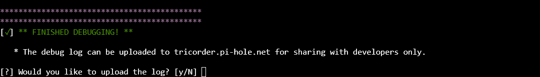

Replace this text with the debug token provided from running pihole -d
Have run the command and the file is located in /var/log/pihole/pihole_debug: however, I can't open/move/upload it as I don't have permission. How do I change this behaviour (please be gentle - Windows user and learning)?

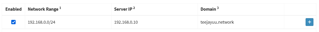

Your current DHCP server is your Synology DS223j, but Pi-hole doesn't know what is configured there.
You can use the reverse DNS server option (also know as Conditional Forwarding). This option will use the other server (Synology DS223j) to return the hostnames.
On the Settings > DNS page, scroll down to the Conditional Forwarding table, then enter the server details:
Replace teejayuu.network with your real network domain.
This will make Pi-hole ask the other server for the hostnames. If the server is able to answer reverse DNS queries, the names will be returned.

Have added the Conditional Forwarding entry and waited till all DHCP leases have renewed (24h) and the DNS entries are not showing in Local DNS.
