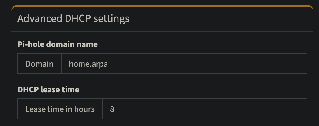

The web interface allows to configure lease time

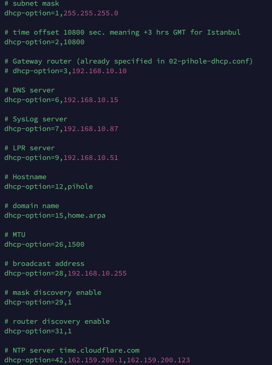

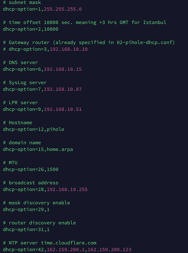

Also in a .conf file under /etc/dnsmasq.d it can be configured via
dhcp-option=51,xxxxx where xxxx is in seconds for the lease time
I also use other DHCP parameters in a .conf file and none of them conflicts with the pihole web interface. I agree DHCP options in dnsmasq is great, much flexible and rich than an ordinary home router settings.

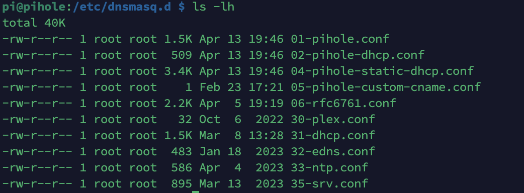

As far as I know, dnsmasq reads all the .conf files under /etc/dnsmasq.d folder in an alphabetic order, that's why it is traditional to name those files aa-xxx.conf, bb-yyyy.conf etc. I have the following files on my folder, all processed by dnasmaq (some are standard pihole .conf files, created on pihole install or written when you change a setting in GUI) I use 30, 31,... and so on to be sure, they are not pihole created files
