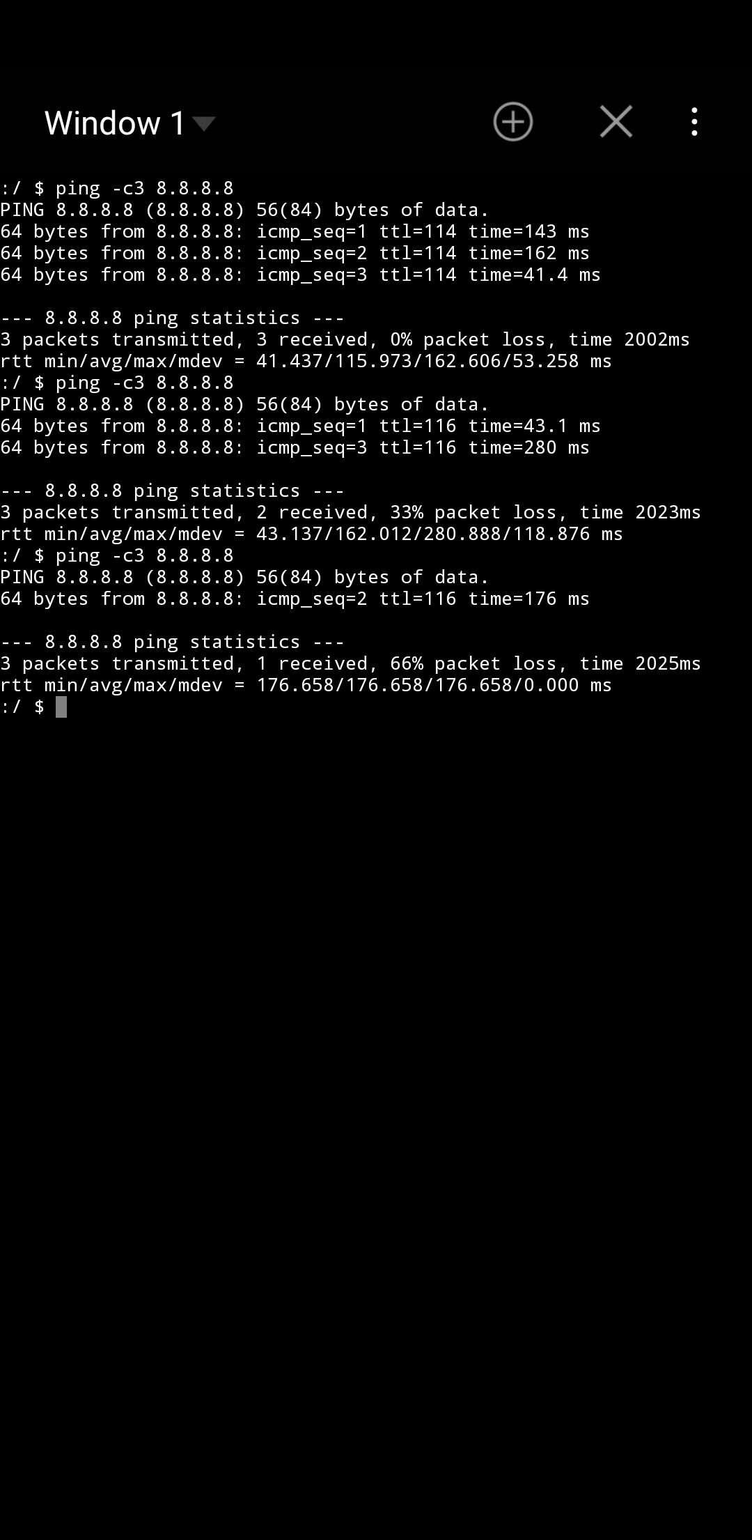

When this happens, are you able to communicate with an external server directly without using DNS resolution? This command from the terminal or command prompt on a client will show:
ping -c3 8.8.8.8

When the connection goes down, it begins losing packets and sometimes it goes down to no packets

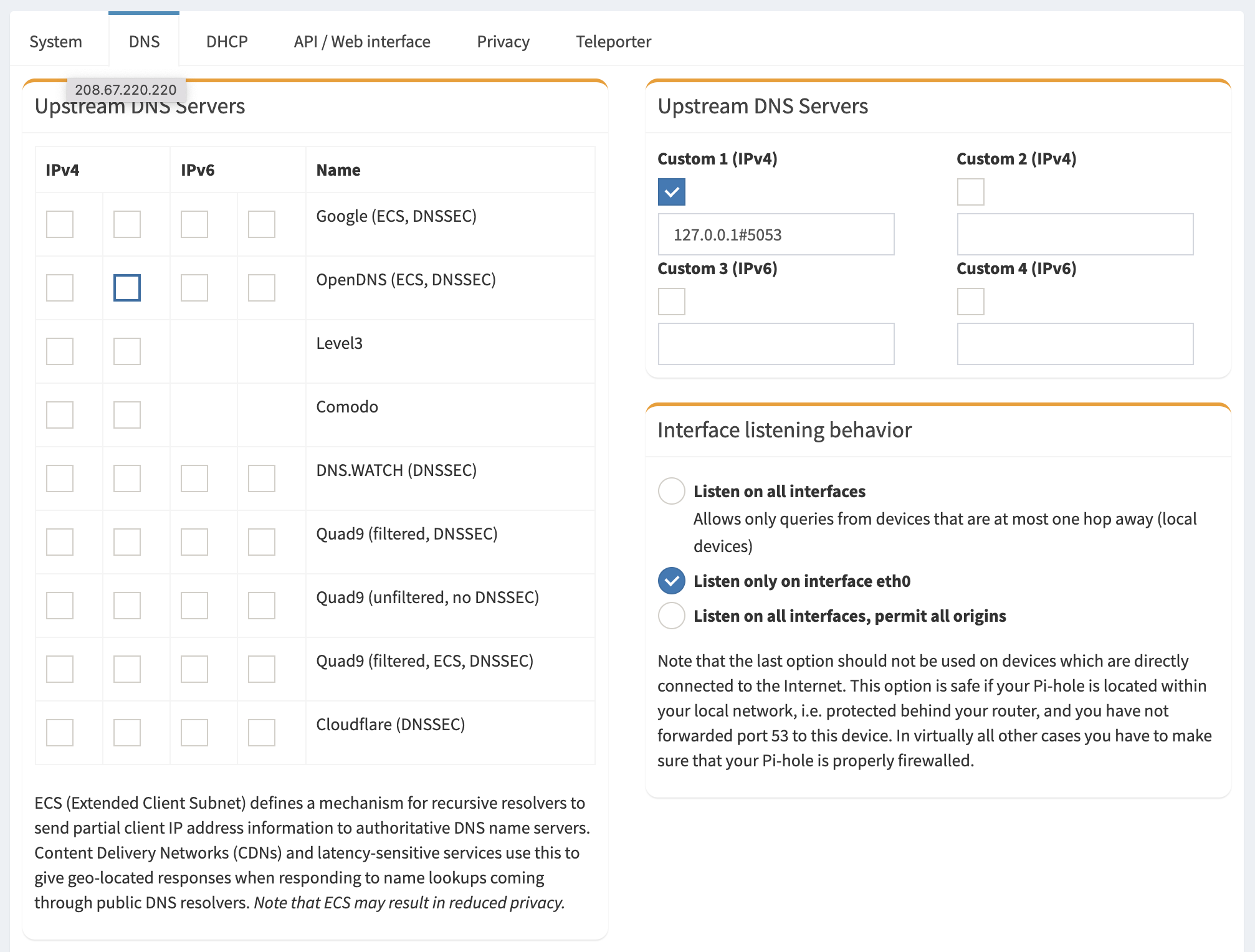

Sorry i was mistaken i've only got the router set to use the PiHoles DNS, DHCP is done by the router.
Would it be worth using one of the the default DNS servers rather than the custom cloudflared (DoH)
Your problem is not related to DNS, or to Pi-hole. When you directly ping an IP (without using any DNS resolution to convert a domain name to an IP), Pi-hole has no involvement with the transaction.
If a client can't connect directly to an IP, that is a network problem, not a Pi-hole problem. Dropped packets with this ping are unrelated to anything that Pi-hole provides on your network. The traffic between the client and the final ping location does not go through, or have any involvement with, Pi-hole.
