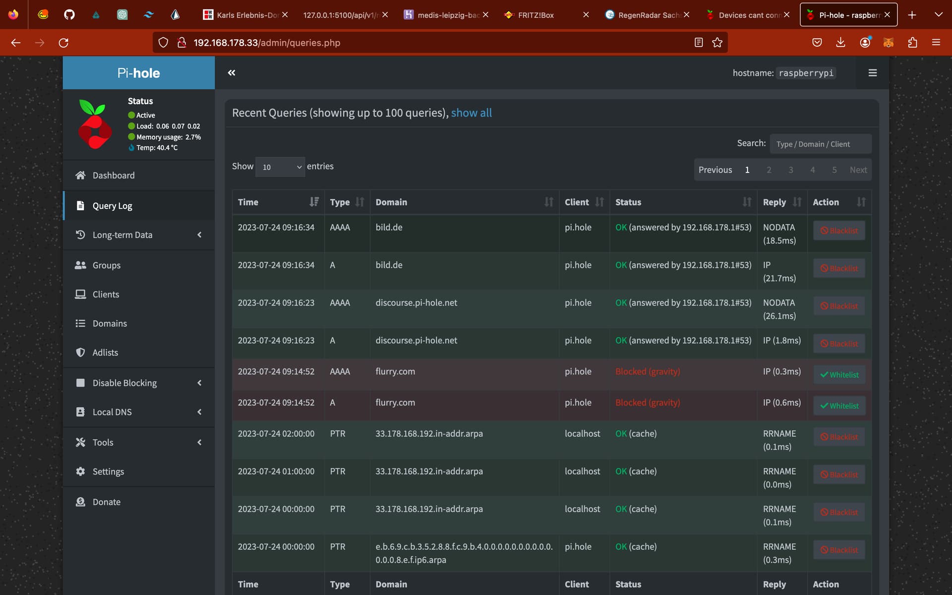

Any devices in my network with the local dns-adresse of the pi-hole (.33) seem to have no internet. There is also no query coming in (from the devices in my network) on the pihole admin interface. The odd one is that querys via nslookup on my pi do appear. Also it only shows 4 clients (2x pi.hole & 2x localhost).

What's the output of
nslookup pi.hole 192.168.178.33
nslookup flurry.com 192.168.178.33
nslookup discourse.pi-hole.net 192.168.178.33
How do those latter two register in your Pi-hole's Query Log?

Only those querys issued on my pi via ssh connection were issued. (That are those from the screenshot) flurry.com gets blocked (as expected i guess) and discourse.pi-hole.net was answered. All querys from devices connected with my router dont receive a server answer (as you can see the connection times out).
