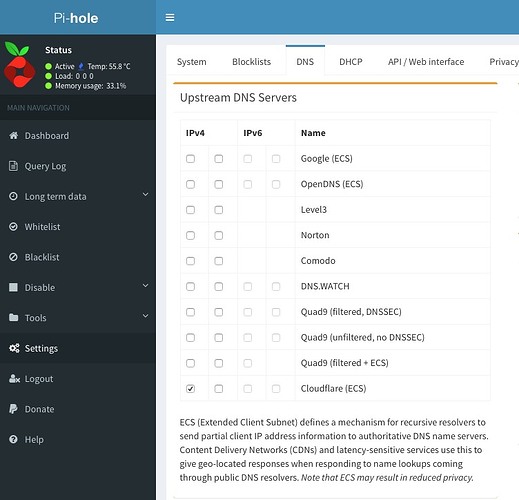

This screen shot from the dev branch of Pi-Hole shows which ISPs provide ECS (for geolocating responses). Using one of these may provide adequate streaming performance.
