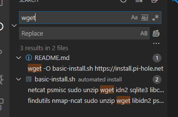

Hi Dan,
sure, so I only remove wget from the dependency and create a PR!?
That should do it. I have done a quick search of the pi-hole/pi-hole repo and I don't see it used. Need to check pi-hole/ftl to be sure but I think it can be removed.
Can concur, it only shows up in README.md
and in the dependency lists:

PR created #3185
