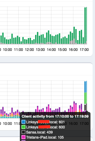

I have a Linksys Velop mesh system with 3 nodes. I use pihole as the DNS server attached by ethernet to the master node. The two satellite nodes fill my logs and dashboard with 600-odd requests every 10 mins as shown below for the last two time periods:
Up to FTL v5.13 I was able to run a version of the script contained in this post to delete these entries by their IP from the database queries table via a cron job running periodically (to get the more meaningful values / display shown to the left of the above screenshot) and restarting the pihole-FTL service.

Sadly not... I cleared the database, switched .local to .lan and still have the two Linksys satellites as the top two clients.
Also seeing the "###.###.##.#.in-addr.arpa" addresses in top permitted domains.
This is exactly why I was wanting the two nodes removed from the databases... I'm hoping the Linksys devices are operating correctly - this behaviour has been noted in other forums. Perhaps this 'exclusion' capability for the reporting is a feature request?
