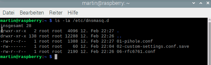

What is the output of ls -la /etc/dnsmasq.d ?
As you can see, the file permissions are different than the other files: -rw-------
You can remove the file with:
sudo rm /etc/dnsmasq.d/02-custom-settings.conf.save

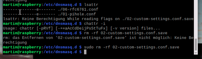

I got it now.
i used cd to change directory to the /etc/dnsmasq.d folder
afterwards i tried to rm again but faild with same fault
i have tried to use sudo rm -rf but it told me that I do not have the rights for it what made me skeptical
i have checked about immutable Bit with lsattr and deleted the immutable bit with chattr -i
afterwards i was able to delete the file
Note that in the first two attempts you typed .safe instead of .save, so the file was not found. In the third attempt there was no sudo so you did not have enough privilege to delete it. In the final attempt you used sudo and the filename was correct and it successfully deleted.
