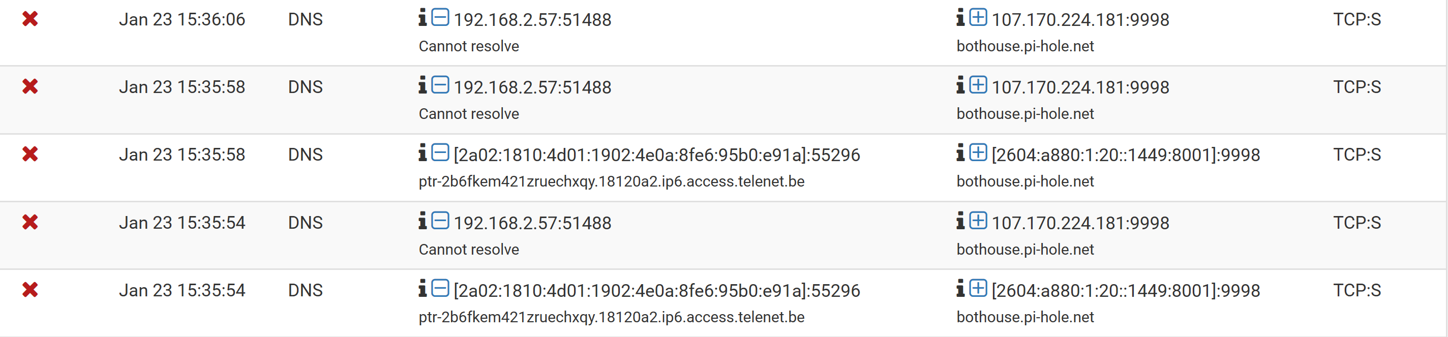

I was looking into the problem with the debug upload. found the following in my firewall logs:
and many more...
pihole (192.168.2.57 and 2a02:1810:4d01:1902:4e0a:8fe6:95b0:e91a) tries to connect to bothouse.pi-hole.net, port 9998.
Evidently, this fails, my firewall doesn't allow this. Is this a requirement for uploading the debug log?

just to find out if this the problem, I created a rule to allow this on my pfsense and tried to generate and upload a debug log.
[✓] Your debug token is: https://tricorder.pi-hole.net/s632j9vpgb
@DL6ER: you can use this log to check problems with the new core tweak/gravity_performance version.
This is probably the reason why many uploads fail. I strongly advise to change that port into something more common, to eliminate the need for all users to add such a rule.
