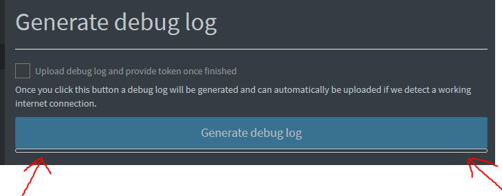

refer to image link, hope that could be use as progression bar as i had a very bad experience with debugging where i waited for more than 30mins and the report is not ready.
https://imgur.com/4LwEBCc
