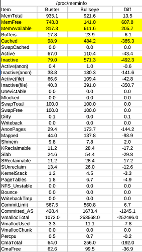

Just some curiousity. I've been running pihole w/unbound on a PI3B+ and it works just fine. I decided to upgrade from Buster to Bullseye ( both installed from raspbery pi's installer ) and noticed that Bullseye is using more memory and running hotter. I've seen some posts about the CPU cycle increase but that seems to apply to PI 4s and not the 3B+s. I'm attaching some basic stats. The only difference here is that the Bullesye build doesn't have unbound installed yet but I can't image that would make it run leaner. Other than that they are the same.
Just curious if this is what others have seen. I'm sticking to buster for now but I know that will be unsupported at somepoint.
I did a comparison of /proc/meminfo and seems like bullseye, in part, is doing more caching? Just seems so different.

Thanks, I'm not too concerned about the cpu running a little hotter its more of wonder why thing. CPU Freq is the same on both as is the voltage readings. A good chunk of the extra memory was due to Raspi-config not being setup for headless. I realized that when top was showing 3 pi users logged in. Its still using almost twice as much as the buster build but quite a bit less ( 11% vs 26% ).
One thing I did notice. On Buster I was able to turn the video off, primarily to save power. In Bullseye they have made some changes and you can do this in the same manner. Disabling dtoverlay=vc4-kms-v3d in the /boot/config.txt file is the closest thing I could find. It doesn't help with the power savings ( from what I read ) but it does bring the temp down about 2c for me. I did a simple temp measurement and while not completely apples to apples you can see the diff pretty clearly. At least it won't be bugging me now :slight_smile:
