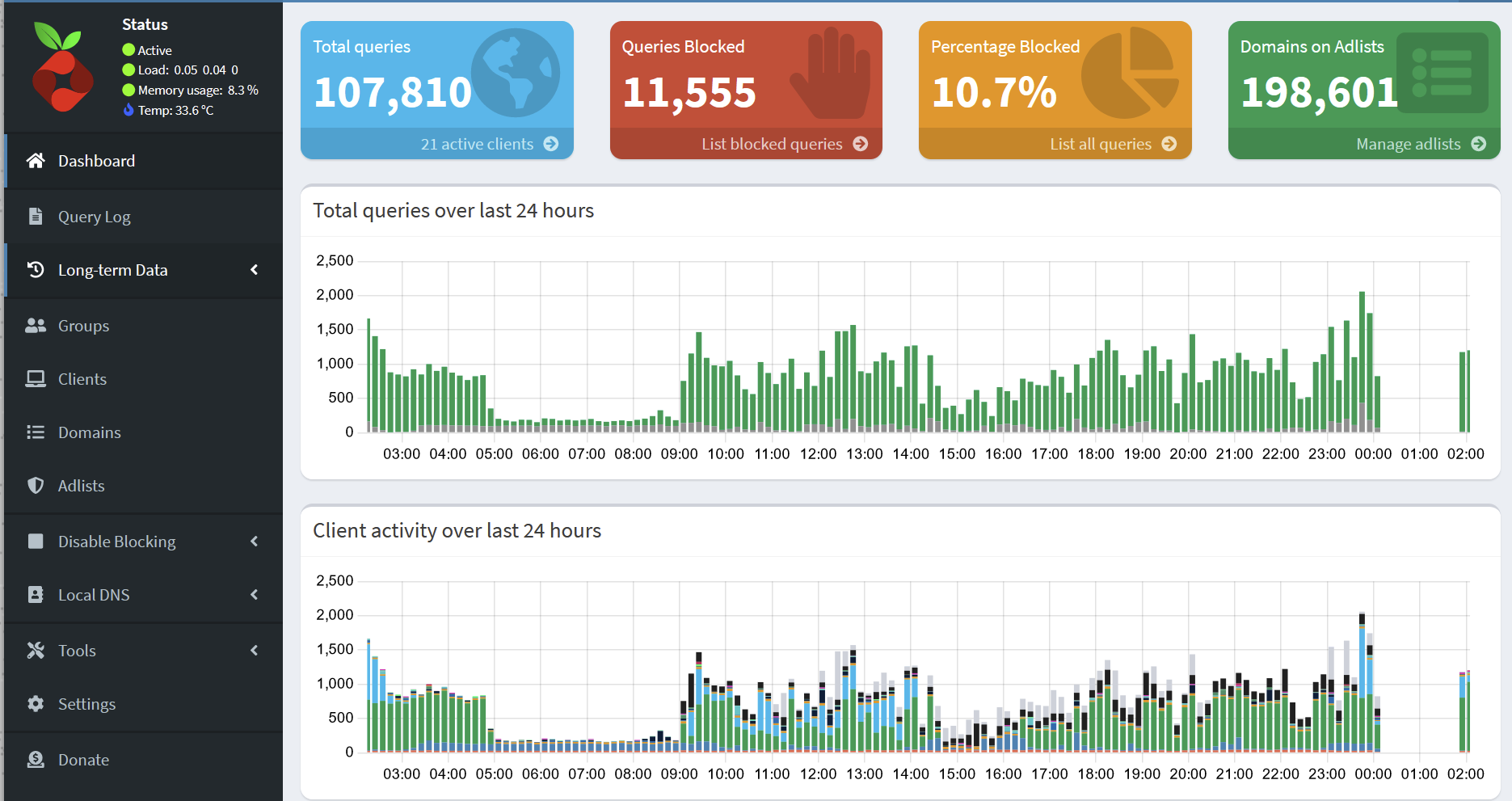

Here's a snippet of the dashboard, showing the gap when the database locked up
What makes you suspect that the database is locked?
Do you encounter any errors during those times that would hint at a database issue?
Commonly, a gap in the dashboard would indicate that Pi-hole has not received any queries during that time, or that Pi-hole would have been terminated, e.g. by a crash. But if Pi-hole would have crashed, it would not recover by itself.

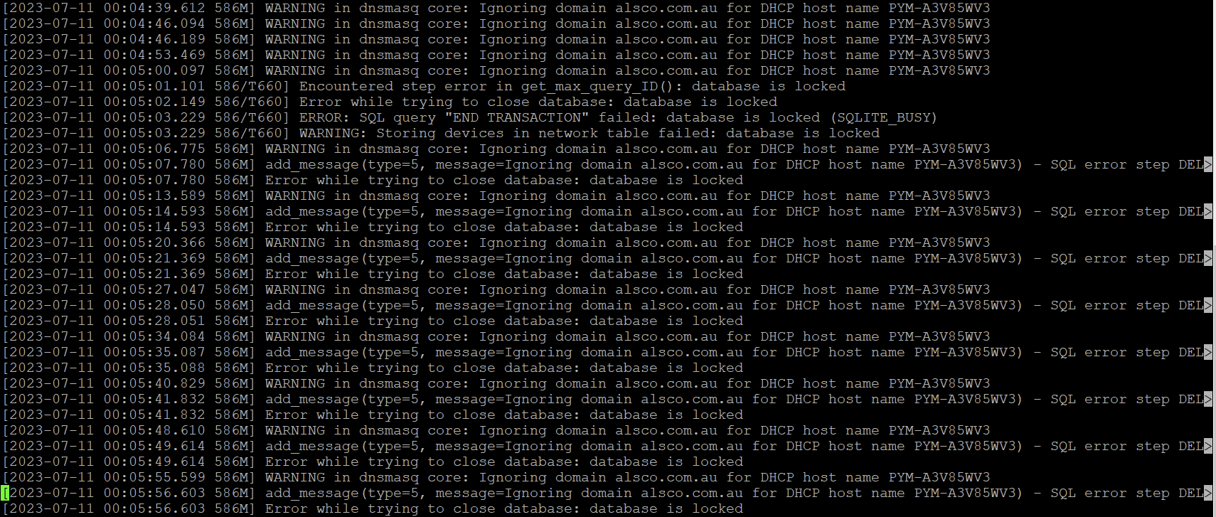

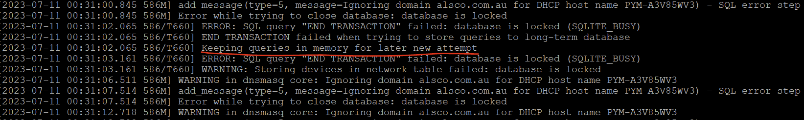

The SQLite database locked messages are from the /var/log/pihole-FTL.log, including the events indicating that
  • Database is locked, so queries/transactions cannot be flushed
  • And hence will be kept in memory

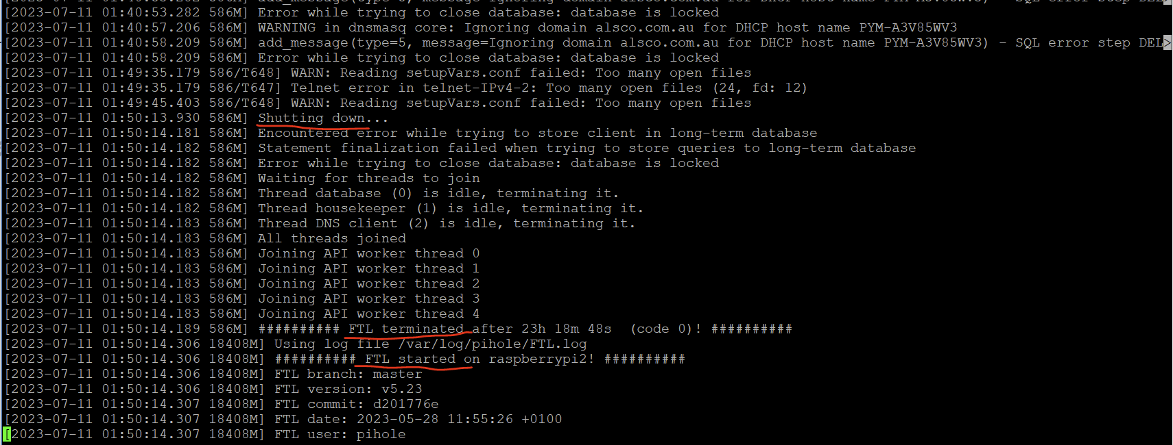

  • These repeat themselves for the next 1 hr 50 mins, after which FTL terminates , and spawns a new instance of the process.
The Time window of this lockup more or less tallies with the gap in dashboard.

Database lockups are normal, but they usually don't last that long.
sqlite3 locks the database when it is writing data.
Usually, when the file is locked, the data is kept in memory and later the data is finally saved to the disk.
This is how a normal log entry looks like when the data is finally stored:
 Notice: Queries stored in long-term database: 277 (took 120.9 ms, last SQLite ID 81964907)
         Queries from earlier attempt(s) stored successfully
Your "in-memory" data should have been stored into the database when the previous operations were finished, but in your case you had an unusually long database lock period.
Queries were never stored in the database, something else (too many open files error) crashed FTL and in memory data was lost, causing the gap.

From the excerpt you show, the respective sequence from the logs looks just like a controlled restart, e.g. as initiated via Pi-hole's UI.
Your debug log suggests that some UI interaction occured at 01:50:08, just five seconds before the shutdown message at 01:50:13 appears in your log, and only a few minutes before the debug log was created at around 01:54.
Did you perhaps restart Pi-hole's DNS resolver as a measure to fix your issue before creating a debug log?
Does that happen at always the same time?
Also, your log shows that Pi-hole has been running for some 23+ hours before it was shutdown, which would have been earlier than the 2 to 3 days that you've observed.
