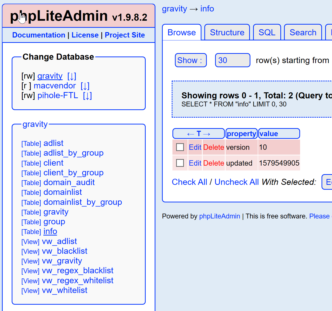

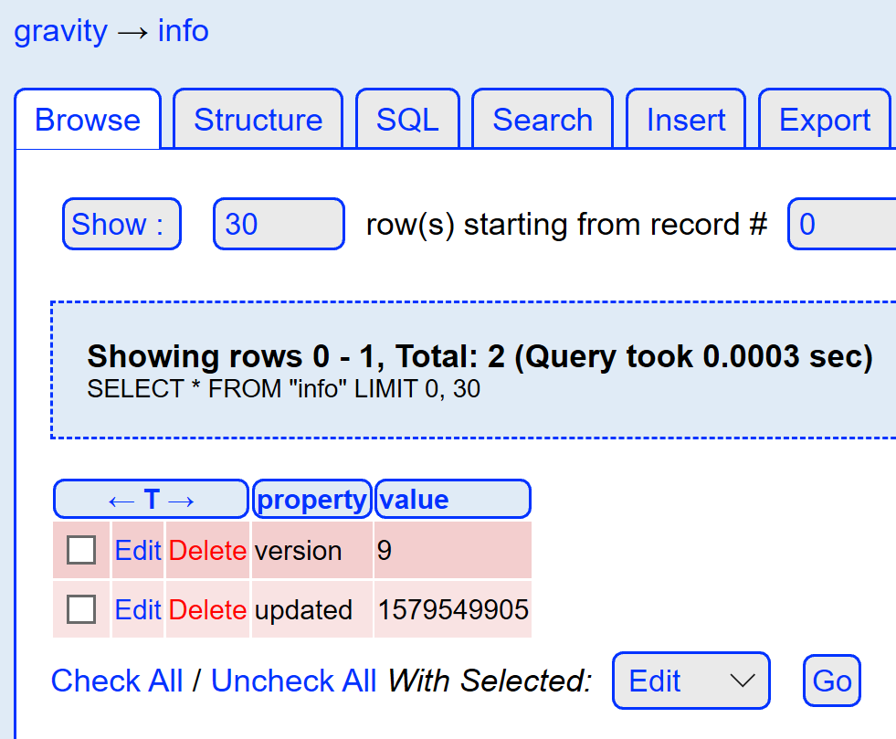

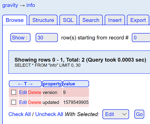

I just ran pihole -up, new core and FTL. The database version still appears to be version 9.
correct? forgotten? not ready yet?

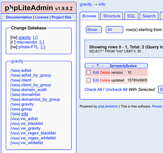

I've applied your update script manually, the obsolete tables appear to be removed. Is it correct to assume pihole-FTL only uses the views?

Yes. They are a convenient way to read only the enabled entries. Furthermore, for domains, they also do the filtering by domain type so you don't have to remember what type regex whitelist, etc. is.
