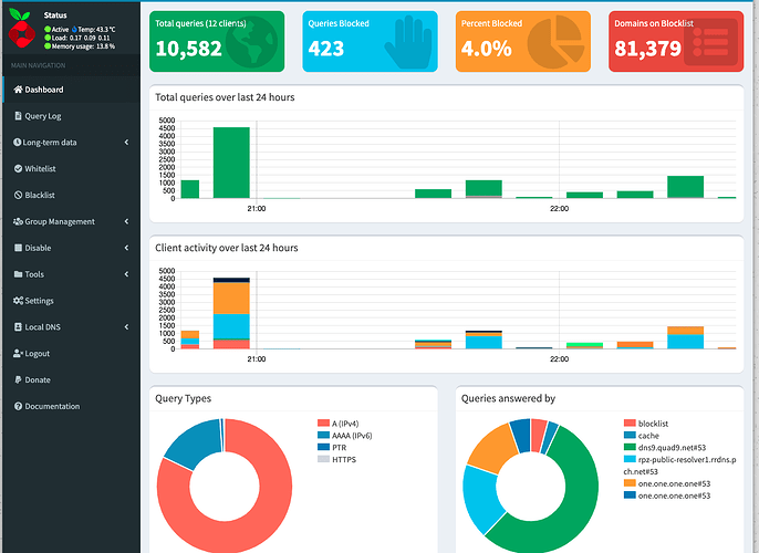

Dashboard says its working but its not blocking any ads

At first I cant connect to internet at all. I saw other topic solution to update the pihole so I did. Now I can connect to the internet but I notice some sites will load indefinitely. The ads are also still present despite dashboard says otherwise. I gave the Raspberry Pi a static IP address and set my router's DNS to match the Raspberry Pi's IP address.

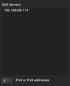

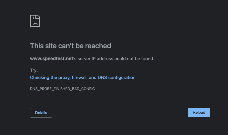

I don't think the problem only lies on the deco. I tried to manually set DNS on my phone to connect to the pihole. The internet ran fine but ads are still popping up. When I connect my mac to the pihole, I can't even reach the internet with error code: DNS_PROBE_FINISHED_BAD_CONFIG. Both only have one Pi-hole DNS address. (I didn't set up the secondary DNS)

How did you verify this on a respective device?
On MacOS, you may want to run
scutil --dns | grep nameserver
On Windows, you should look for the DNS sever section in the output of
ipconfig /all
yepp only one
and can't connect to internet

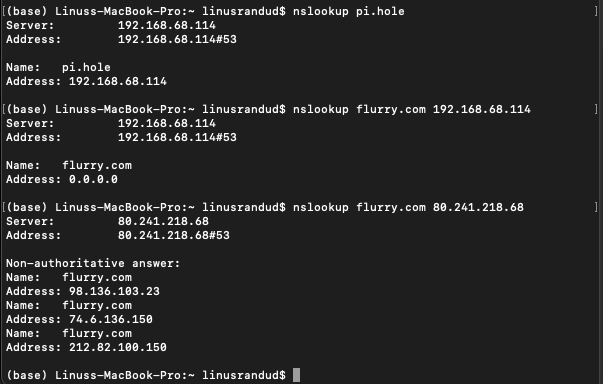

From your MacBook, what's the output of:
nslookup pi.hole
nslookup flurry.com 192.168.68.114
nslookup flurry.com 80.241.218.68
The results for the first two commands are OK:
Pi-hole is used for DNS, it's providing its own local name, and it's also blocking flurry.com.
Let's see if your Pi-hole can provide resolution for public names as well:
nslookup google.com
The third command, however, indicates that something - presumably, your router- would redirect DNS requests to public DNS servers: The public server at 80.241.218.68 would block flurry.com as well, yet you received a set of IP addresses as answer.

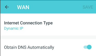

Interesting. How do I disable this redirection? (I used Deco M4 as stated before). I can tell you that in the WAN settings, that "Obtain DNS Automatically" is on. Is this related?

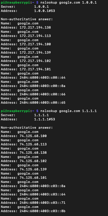

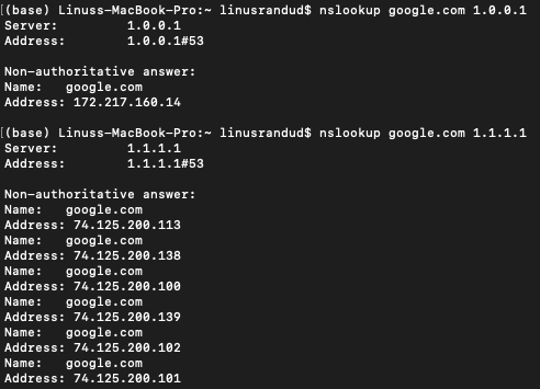

Do those upstream DNS server(s) resolve propely if you do below on the Mac client and on Pi-hole:
nslookup google.com <UPSTREAM_DNS_SERVER_IP>
I'm using cloudflare 1.1.1.1 and 1.0.0.1
Yes.

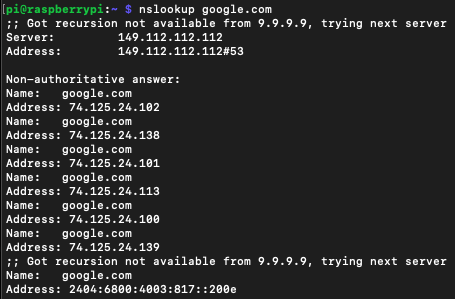

While it demonstrates that your client has used Pi-hole at 192.168.68.114 for that DNS request (so accessing local DNS servers is not redirected by your router), it should have returned a bunch of IPs instead of SERVFAIL.
Please run an nslookup for google.com from your Pi-hole RPi and share the output.
Also, both your debug logs indicate you are using DNSSEC.
DNSSEC requires correct timing information, so that could also cause failures if it would be off by more than a margin.
Verify your date and timezone are current on your RPi.

Well, yes. I decided to set my devices DNS manually instead of set it on the router to minimize the potential error points. Currently it is set to dynamic IP with "Obtain DNS Automatically" on (previously I set the DNS on router by turning off the "Obtain DNS Automatically" and set it to pihole ip.
