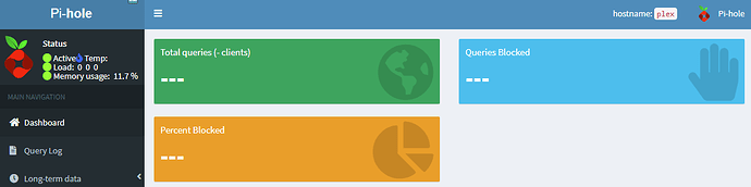

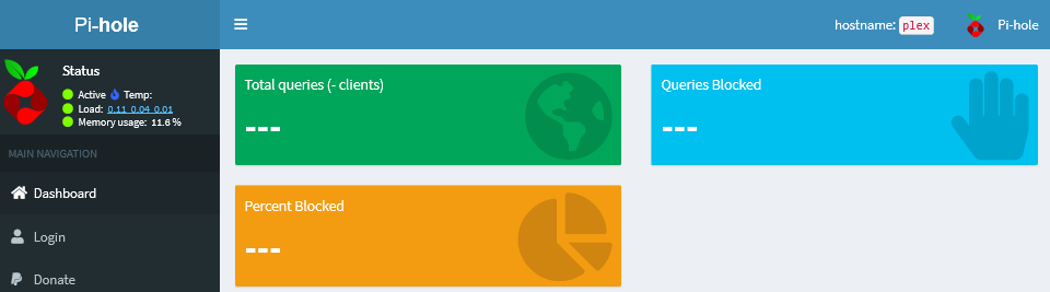

I am running Pihole behind Apache. It worked fine with version 4.4. After upgrading to 5.1.2, the dashboard is showing --- for all three boxes (Total queries, queries blocked and percent blocked). Other tabs are showing data. It's just the Dashboard (including the Status area) which is messed up.

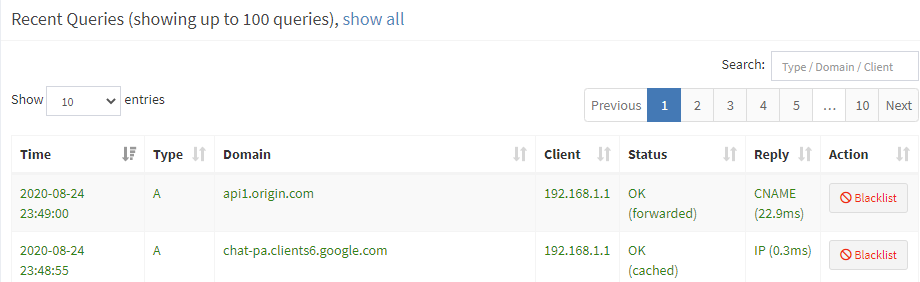

There are queries in the query log, so it is definitely running.

The Load started showing after doing CTRL-Reload in Chrome:

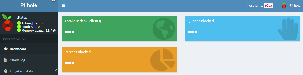

I tried with another browser (Edge). No difference (except uglier).
I restarted Apache. No change.
