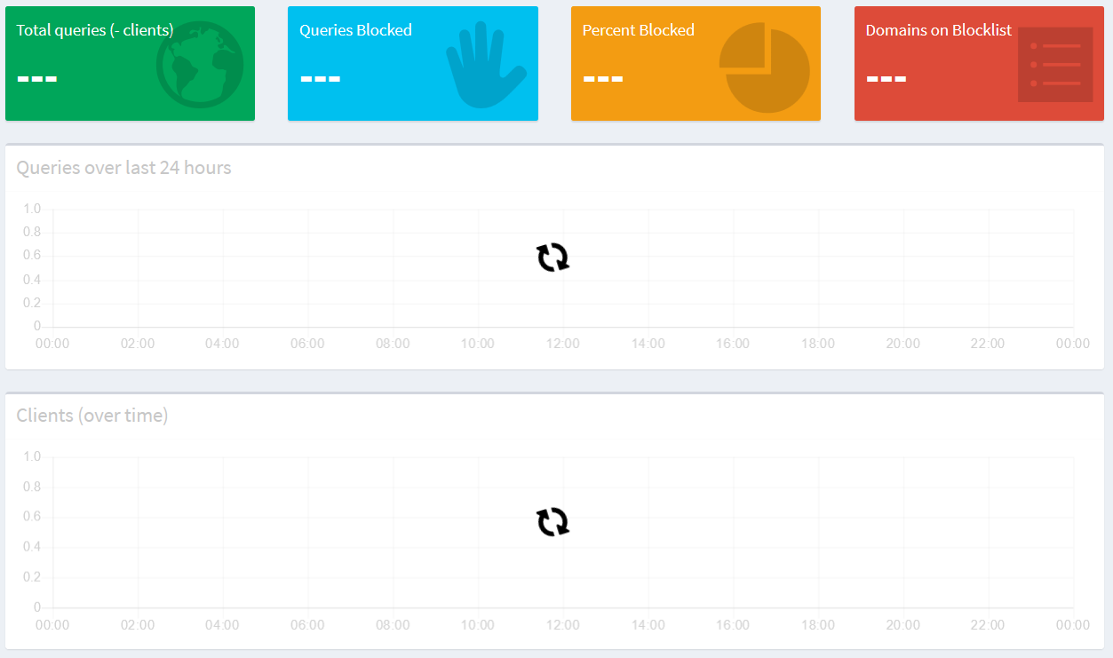

Dashboard not working (No Data)

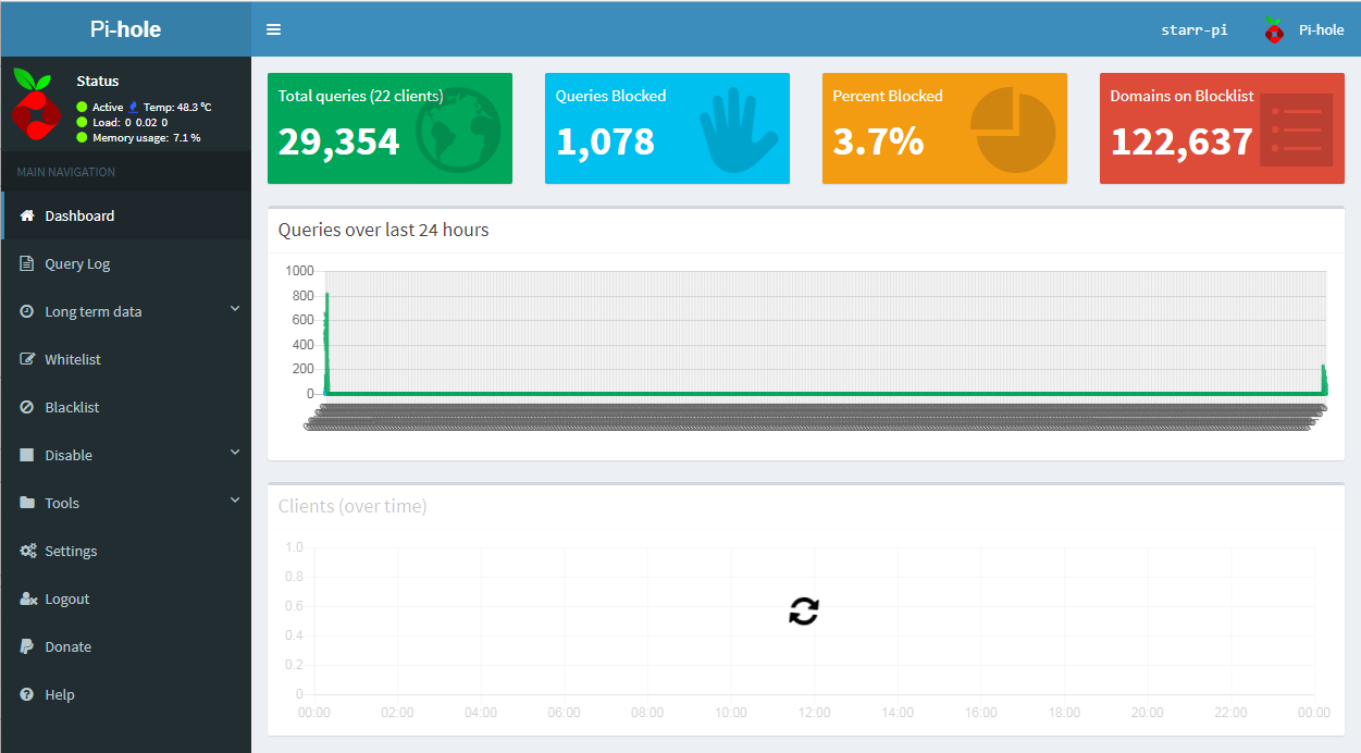

Hello everybody,
I've got a problem can anyone please help me?
I'm not quite sure if my pi-hole is working correct because I still see ads (maybe a fewer but they are still there). So I wanted to check if everything is working fine: I opned the dashboard and the only information I see are just the "infinity loading circles".

Can anyone help me? :slight_smile:
We've seen this with the Chrome browser, are you using this browser, and does the same thing happen with other browsers?
Hi DanSchaper,
thank you for your answer. I've got the same problem with IE, Firefox, Chrome and Safari. I even tried Windows, Linux and iOS. On every device and browser the same problem.
Not sure with my old version of Pi-hole but you seem to be missing the 'log-queries' directive in the dnsmasq config file '/etc/dnsmasq.d/01-pihole.conf' ?????
For diagnosing, you could add a line to that config file with the 'log-queries' directive + run 'sudo service dnsmasq restart' to apply.
Could delete the line again if not solving the issue.
Thank you for the hit. Can you tell my where the log-queries are placed?
I could not find anything about this.:roll_eyes:
With below one you can edit the config file:
sudo nano /etc/dnsmasq.d/01-pihole.conf
Add an extra line at the end of the file with "log-queries".
Save the file by pressing CTRL-x.
And restart the dnsmasq daemon to apply:
EDIT: Ps. during Pi-hole setup, your asked if you want Pi-hole to log DNS queries, do you remember what you entered ?
EDIT2: Never mind, from the debug log, it seems you entered NO:
Logging is required for any data to be displayed on the dashboard ... I believe ???
If adding that line works, better make it persistent by running below one:
pihole -r
And asnwer yes when asked for loggings.
Edditing the config file changed nothing.
Now I reconfigurated the pi-hole. I entered everything as recomended (queries enabled) but the problem still arises.
Here are the outputmessages:

I'm not sure if this is a problem but maybe it has something todo with the dashboard-problem?
> pi@raspberrypi:~ $ curl -I 192.168.2.104
> HTTP/1.1 200 OK
> X-Powered-By: PHP/7.0.27-0+deb9u1
> Content-type: text/html; charset=UTF-8
> Date: Sun, 25 Feb 2018 18:26:54 GMT
> Server: lighttpd/1.4.45
> pi@raspberrypi:~ $ curl -I 192.168.2.104/admin
> HTTP/1.1 301 Moved Permanently
> Location: http://192.168.2.104/admin/
> Date: Sun, 25 Feb 2018 18:27:10 GMT
And when pressing CTRL-F5 in the browser when viewing the dashboard or try another browser ?
Maybe run another debug for the devs to have a look ?
That's fine, that's pulling the blockpage if you grab the contents.
This is also as expected, this is a redirect from /admin to /admin/. Try curling 192.168.2.104/admin/ and you should get a 200 and the contents of the admin page.
Similar issue - not workin in Safari but works in Chrome on the same machine. Submitted the logs - not sure where to put the debug token so someone can look at the logs.
If it's working on Chrome, then the logs wont show much since it appears to be a browser specific issue. I don't have any Apple devices to be able to check Safari, but I think @jacob.salmela might have something.
I could not reproduce this.
When you did pihole -r > Reconfigure, did you choose to enable logging during the process?
Similar issue here. I'm running Raspbian Jessie v8, and performed
pihole -up
albeit not from root. I seem to have successfully upgraded from quite an old version to:
Pi-hole Version v3.3
Web Interface Version v3.3
FTL Version v3.0
shows no faults, except for the "not backing up my index.lighttpd.html because it doesn't exist" information.
However the webUI now fails to display graphs. I flushed the query logs in case there was some issue in pre-upgrade data, but the statistics still show old summaries and the graphs still seem to have melted (after taking a while to load at all).
Addendum - I ran
pihole -r
as well, to no avail.
