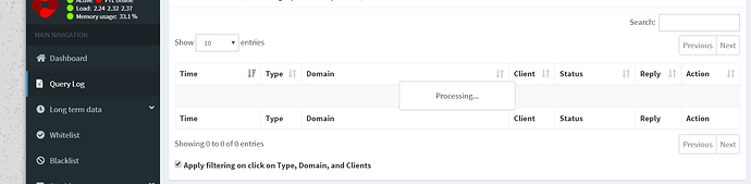

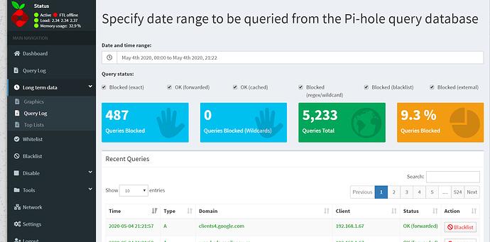

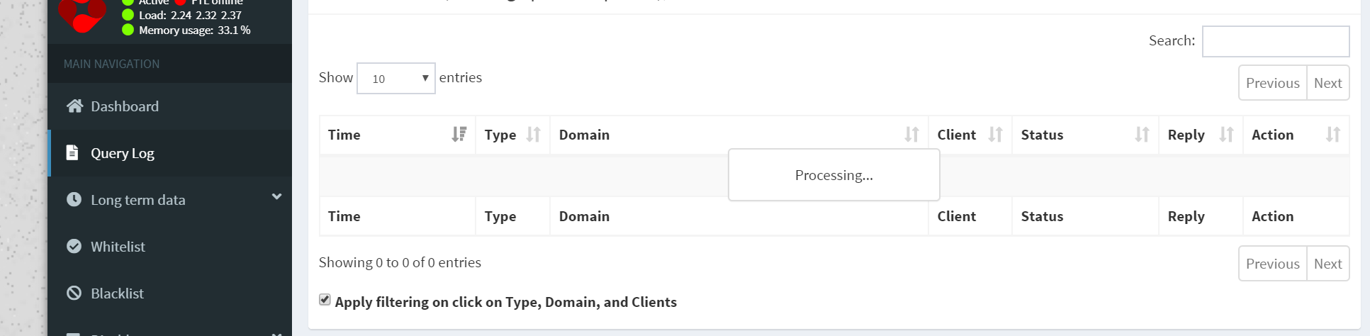

_[Dashboard keeps spinning and query log shows processing, but nothing happens. However query log under long term data does show results.

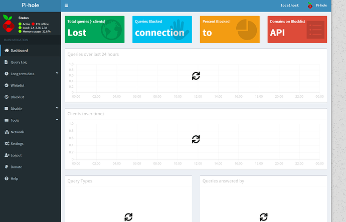

Please do two things.
  1. Post a screen capture of what you see on the dashboard. In this forum, you can either upload an image or directly paste the clipboard into a reply.
Restart lighttpd and see if this changes what you see on the screen. Refresh the page after the restart command:
sudo service lighttpd restart
After restart of lighttpd its the same

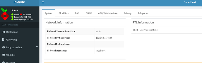

Are below two PHP mods installed and enabled ?
pi@noads:~ $ php-cgi -m | grep 'json\|sqlite3'
json
sqlite3
FYI:
[βœ“] Ubuntu 18.04 LTS
Thanks but after closer inspection, I suspect another Android Linux deploy that we dont have a fix for I think:
@deHakkelaar Yes its Android linux..
