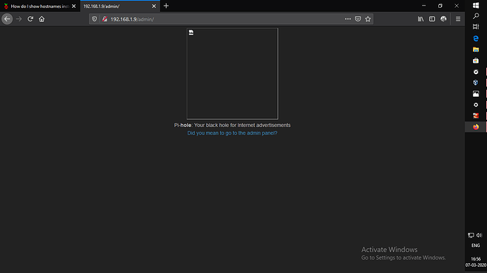

Dashboard is not loading properly
The pi-hole dashboard loads and I'll use my admin password and monitor the pi-hole's behaviour
Pi-hole dashboard doesn't loard no error message

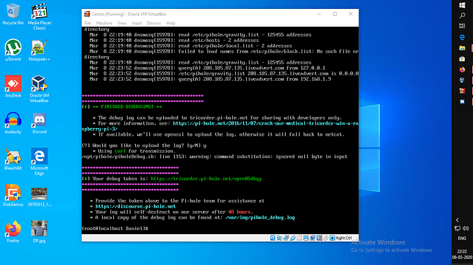

Your debug token is: https://tricorder.pi-hole.net/vpre05dbqg
We do not support SELinux enforced. The installer should have displayed a screen to notify you of this.
*** [ DIAGNOSING ]: SELinux
[✗] Default SELinux: enforcing
[✗] Current SELinux: Enforcing
[✗] Block page X-Header: X-Header does not match or could not be retrieved.
HTTP/1.1 200 OK
X-Powered-By: PHP/7.2.11
Date: Sun, 08 Mar 2020 16:53:53 GMT
Server: lighttpd/1.4.55
[✓] Web interface X-Header: X-Pi-hole: The Pi-hole Web interface is working!
2020-03-08 22:23:53: (mod_fastcgi.c.421) FastCGI-stderr: PHP Warning:  file(http://127.0.0.1/admin/scripts/pi-hole/php/queryads.php?domain=localhost&bp): failed to open stream: Permission denied in /var/www/html/pihole/index.php on line 130
Then what should I do to resolve that issue
Write a policy to allow what you would like to allow.

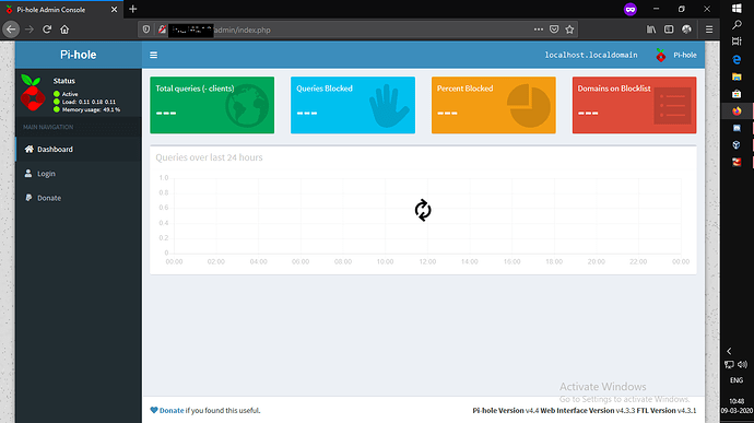

Finally I can now access the dashboard or the web interface but the reload icon keeps spinning

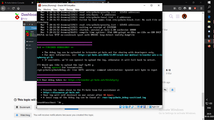

It is easier for us to help you when you copy and paste the token as text, rather than a screenshot of the text.
52s2ufgi1j

Now I'm runing the latest version yet doesn't change anything
https://tricorder.pi-hole.net/m7rykfe04q
-rw-r--r--. 1 lighttpd lighttpd 1723 Mar 10 09:12 /var/log/lighttpd/error.log
   2020-03-10 09:09:32: (server.c.1488) server started (lighttpd/1.4.55)
   2020-03-10 09:10:02: (mod_fastcgi.c.421) FastCGI-stderr: PHP Fatal error:  Uncaught Error: Call to undefined function json_encode() in /var/www/html/admin/api.php:139
   2020-03-10 09:10:02: (mod_fastcgi.c.421) FastCGI-stderr: Stack trace:
   2020-03-10 09:10:02: (mod_fastcgi.c.421) FastCGI-stderr:   thrown in /var/www/html/admin/api.php on line 139
   2020-03-10 09:11:03: (mod_fastcgi.c.421) FastCGI-stderr: PHP Fatal error:  Uncaught Error: Call to undefined function json_encode() in /var/www/html/admin/api.php:139
   2020-03-10 09:11:03: (mod_fastcgi.c.421) FastCGI-stderr: Stack trace:
   2020-03-10 09:11:03: (mod_fastcgi.c.421) FastCGI-stderr:   thrown in /var/www/html/admin/api.php on line 139
   2020-03-10 09:12:03: (mod_fastcgi.c.421) FastCGI-stderr: PHP Fatal error:  Uncaught Error: Call to undefined function json_encode() in /var/www/html/admin/api.php:139
   2020-03-10 09:12:03: (mod_fastcgi.c.421) FastCGI-stderr: Stack trace:
   2020-03-10 09:12:03: (mod_fastcgi.c.421) FastCGI-stderr:   thrown in /var/www/html/admin/api.php on line 139
https://discourse.pi-hole.net/search?q=centos%20json_encode
