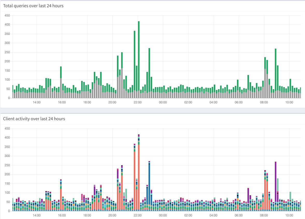

This is what I'm seeing on the new install...

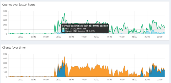

This is (similar to) what I was previously seeing...
That's definitely Pi-hole 5 (top) vs. Pi-hole 4 (down).

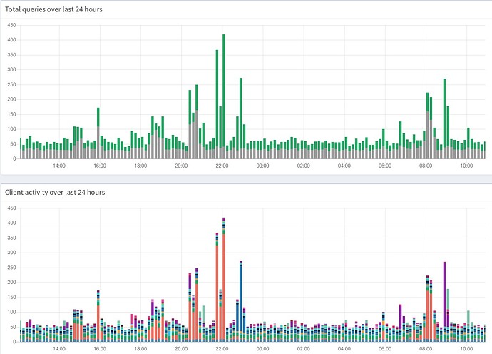

The "chunkiness" of the new install is due to the fact that the Pi-hole has only been running for a few hours at most. The bars scale in width. After you have the full 24 hours of data on the graph, the bars will look like this:
