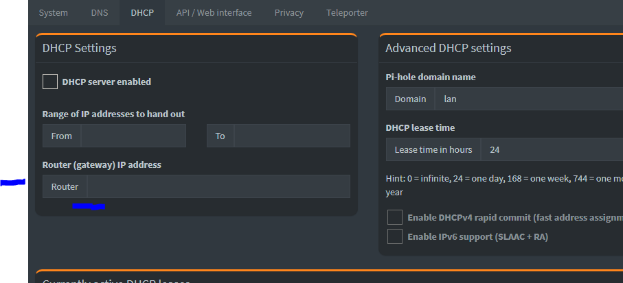

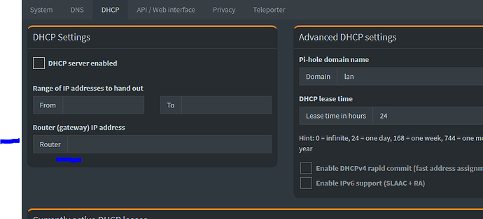

I am considering swapping my dhcp server to my pihole.
Before I do can someone please clarify what gateway this field is referring to?
My main asus (RT-AC86U) gateway is 192.168.1.105. My pihole 192.168.1.215
I assume I complete this field with 192.168.1.105 as it will still operate as the gateway router but not dhcp anyore?
Thanks
Think I just found the answer -
Why is a default gateway important for Pi-hole? - FAQs - Pi-hole Userspace
So yes 192.168.1.105 for the pihole gateway.
Makes sense - PPPoe gateway to the internet (via ISP bridge).

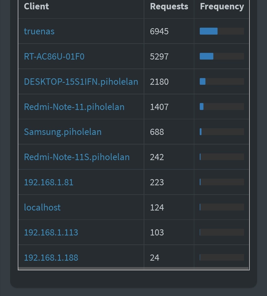

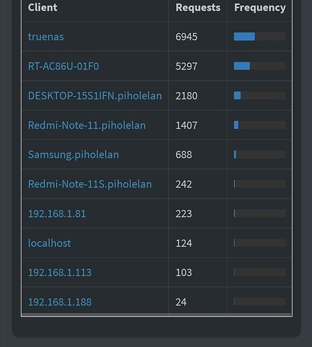

Been running overnight perfectly. Just one question.
I see some devices have the host name (piholelan) appended and some don't.
Is this because the ip hasn't renewed yet? (24 hour lease)
Thanks
I see now only the ip static assignments are appended with the host name
