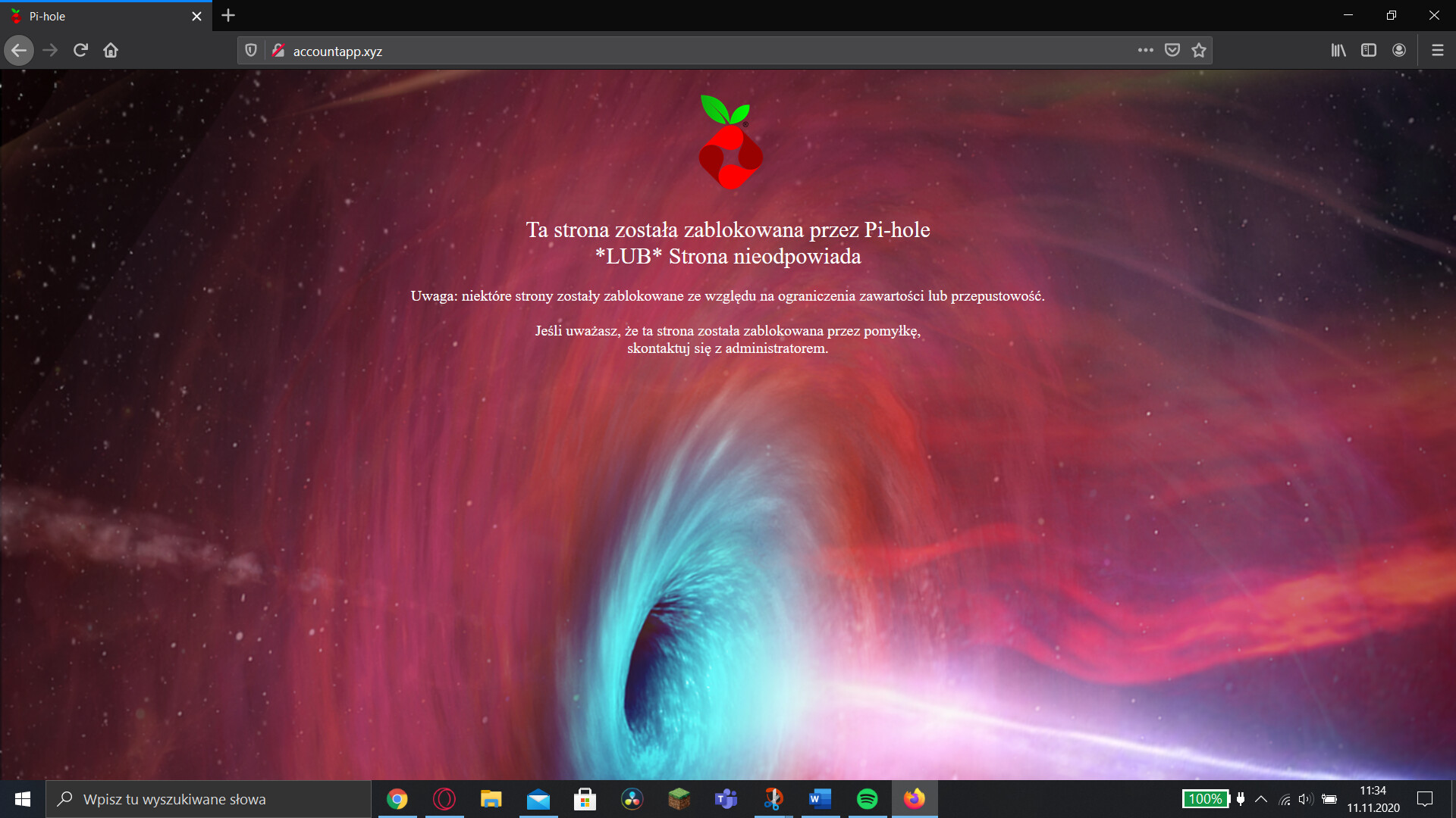

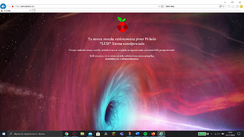

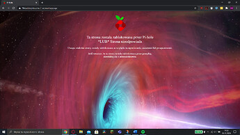

Sorry, I haven't been on here in a long time... Incase you didn't find an answer:
Someone suggested below that the following is missing a forward slash at the beginning of the file location:
server.error-handler-404="pihole/CustomBlockPage.htm"
This was assuming that Pi-Hole knows its own location in the drive structure. You can try modifying this to match the file structure of your installation to see if that helps.
Correct, it shouldn't care what extension, especially when ".htm" is part of the HTML standard. ".htm" was used because DOS and Windows 3.1 only supported 3 character file extensions. But it appears to no longer work in the newer version of pi-hole. Instead the page is served as a download instead of a viewable page. That sounds like a bug of some sort. I also found that the block page now only appears if you put in the Pi-Hole's IP address (and only when you change the extension to ".php"). Something has changed. (Correction... it does still work with an actual 404 error with the .php extension)
