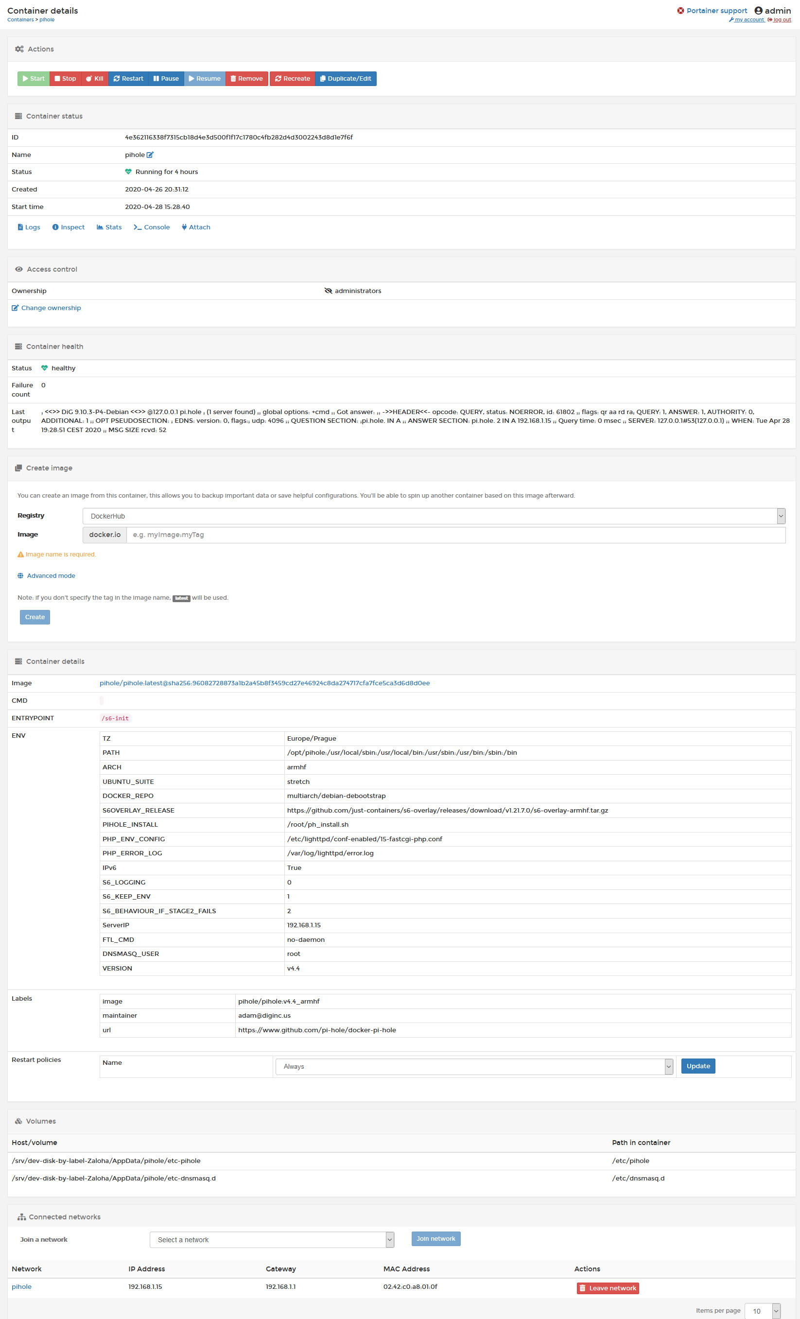

Hello,
I have a NAS(openmediavault) that has more services. One of them is a pihole and I would need to move it to a different IP address than the base address of the server. This is because DNS port 53 at the main server IP address is already occupied. Example:
IP address of the main server and other services: 192.168.1.10
IP address of the pihole: 192.168.1.15
I know it should be solved via macvlan. I tried:
docker network create -d macvlan \
   --subnet = 192.168.1.0 / 24 \
   --gateway = 192.168.1.1 \
   -o parent = eth0 pihole
The address of my router is 192.168.1.1.
I then assigned the container to this network and changed the IP address of the container with the pihole to 192.168.1.15. I also made a change in the pihole settings.
Unfortunately, I was not successful. I am a beginner with docker, so I will ask for simple advice / solutions.
Thanks…

While we provide no official support for docker GUIs, there may well be users around that know their way arouf with your specifc UI, so it's good that you posted those screenshots.

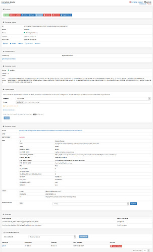

Thanks for advice. I finally solved it with this configuration: Add a PiHole instance on a macvlan enabled Docker network (Synology eth0 example) · GitHub
It seems to me that in the end it helped me to update the system with sudo rpi-update.(linux - Docker MACVLAN only works Outbound - Stack Overflow)
After the restart it started to work, but I still don't see any connected ports in the portainer. But the website works, so I think I was successful.
