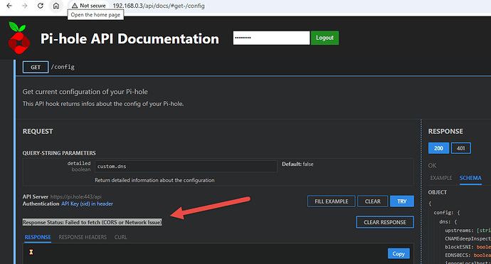

also, one of the reasons I'm having a tougher time figuring this out, is because I'm getting a strange CORS issue when attempting to play with the examples from the api docs

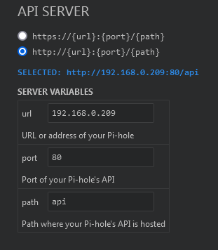

You are using the IP 192.168.0.3 to access the API documentation.
Did you change the API SERVER values to match your URL?
You are amazing thank you!!
